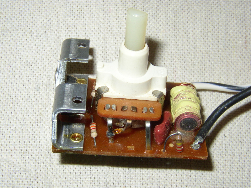

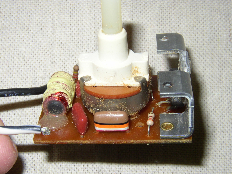

With an ohmmeter, can you tell if the coil in PIC 029.JPG is open or not?
The waxy looking substance puddled at either end of that coil I suspect is melt down from the coil.

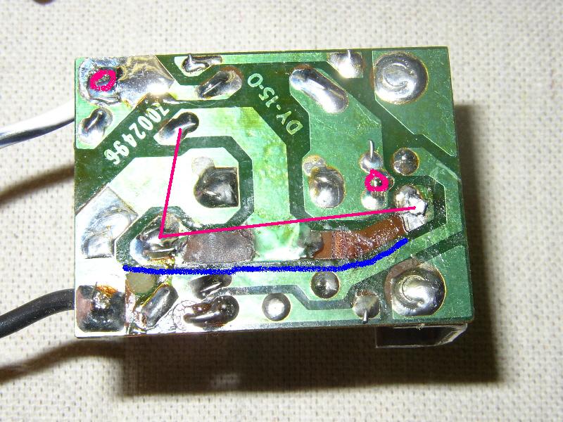

If it were me I would try to run two jumpers I have them as straight red lines on your photo.
I would then touch my soldering iron to the 2 red spots as they might be cold solder joints.
Lastly I would run something sharp down the board blue line to make sure there is no short between the two circuits on either sid
Then I would try it.
The coil may be shot but I would try what I suggestted first.
Ed[ATTACH]2360[/ATTACH]

A simple ohmmeter check of the coil might work but that is hard to say without seeing the circuit. The coil might be shunted by other components giving a false reading. You may have to unsolder the coil from the circuit to be able to tell.
Follow Ed's advice first. You just might fix the circuit without doing anything to the coil.
If your ohmmeter leads are sharp, you can probably penetrate that varnish coat to make the resistance checks that Ed suggests.

Can you read the number on the component that is attached to the aluminum heat sink at one end of the board? I suspect that it's the thing that has gone south. Everything else looks intact.tdubnik wrote:The last two pictures.

The part is a small black rectangle with 3 leads soldered to the board. It appears that the numbers are 0973.johnm wrote:Can you read the number on the component that is attached to the aluminum heat sink at one end of the board? I suspect that it's the thing that has gone south. Everything else looks intact.

Thanks for the suggestion Ed. I'll give it a try this afternoon.Ed in Tampa wrote:If it were me I would try to run two jumpers I have them as straight red lines on your photo.
I don't see anything that I recognize as a diode (rectifier) but there has to be one. With amount of heat developed, the current through that diode would have been significant. The diode would therefore be suspect also.
The diode might be the form around which the coil is wound.
I am attempting to create a drawing of the circuit using the photos provided. I think it can be done (unless there are components under the potentiometer that can't be detected).
Are there any markings that might be part numbers on the components. I am particularly interested in the tan colored one (w/red,white,orange and black strips).
Is there a component up inside of that metal bracket (029.JPG)?
The resistors look fine. When you measure the potentiometer, do you get an indication that it works (a variable resistance)? In 029 I can see a number which I would bet is the part number for the poteniometer.
