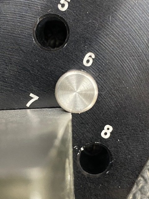

Ed,
Agreed, but he doesn't want to use the 6" aluminum bar and he doesn't want to make a sacrificial fence. My point is he keeps saying that the Shopsmith miter gauge won't reach the 6 pin and I showed pics of mine showing the opposite. I didn't even use the aluminum bar in my pics to reach the 6 pin.
Unless the earlier Shopsmith miter gauges are a lot smaller than mine I don't understand why he has a problem. Hence we need pics from him.

Posts: 4190
Re: More On Disappointed In MiterSet
RFGuy,
Thanks for including the Manual. I can see in your previous post's picture that the miter touches the 6 segment pin but from the angle I cannot be sure it is fully touching across the pin as suggested by cliffy.
I don't believe the width of the Shopsmith miter protractor face has changed. I compared a greenie, older gray and a newer gray and they are all the same width. It is interesting that the manual says to use the supplied bar for narrower miters but cliffy's apparently didn't have it. The Shopsmith online catalog only mentions the Detent Bar (Standard jig only) but nothing about a 6” aluminum bar for the Shopsmith version as stated in the Manual on page 7.

Post by RFGuy »
chapmanruss wrote: Tue Mar 09, 2021 1:24 pm RFGuy,
Yeah, there is definitely parallax in the picture, but I can assure you that the edge of the pin (at its peak) is sitting on the edge of the miter gauge with maybe a few mm to spare for the "6" position.

OK. I am wrong. I went back to check it again. I had to take a picture and zoom in to see it. Apparently my eyes deceived me because in the picture you can clearly see that the centerline (top of the pin) falls just outside of the Shopsmith miter gauge for pin position "6". Also, there is no 6" aluminum bar in my MiterSet Segments case, but there is one in the MiterSet Standard, however this bar is for setting half degree angles so it sounds like there was a different flat bar that was supposed to be included in the MiterSet Segments. Mine didn't come with it though. Looks like the only real option to do what the OP wants is to use the MiterSet Segments with an extension fence on the Shopsmith miter gauge.
📶RF Guy

Post by edflorence »
Great picture, RFGuy. It clearly shows the need for the "6”
aluminum bar for the Shopsmith version" mentioned in the manual. Sounds like maybe some of the Shopsmith versions got shipped without it.
As for the "slop", I double checked my Standard Miter Set and found that my gray miter gauge fits with no discernible movement. There is a gap that appears on one side between the bar and the slot near the upper end of the slot and this gap extends back maybe an inch and a half or so. I could barely get the tip of an .003" feeler in it. No gap on the other side of the bar, and no "wiggle" at all in the fit.
Maybe the OP has a couple of issues going on: 1) as mentioned early on in this thread, maybe he is using a MiterSet that is not the Shopsmith Version. The box for the one I have is clearly marked as being the Shopsmith version. This would explain the poor fit. 2) Missing the 6" bar. But, as noted, a flat extension bolted to the miter gauge should work.
