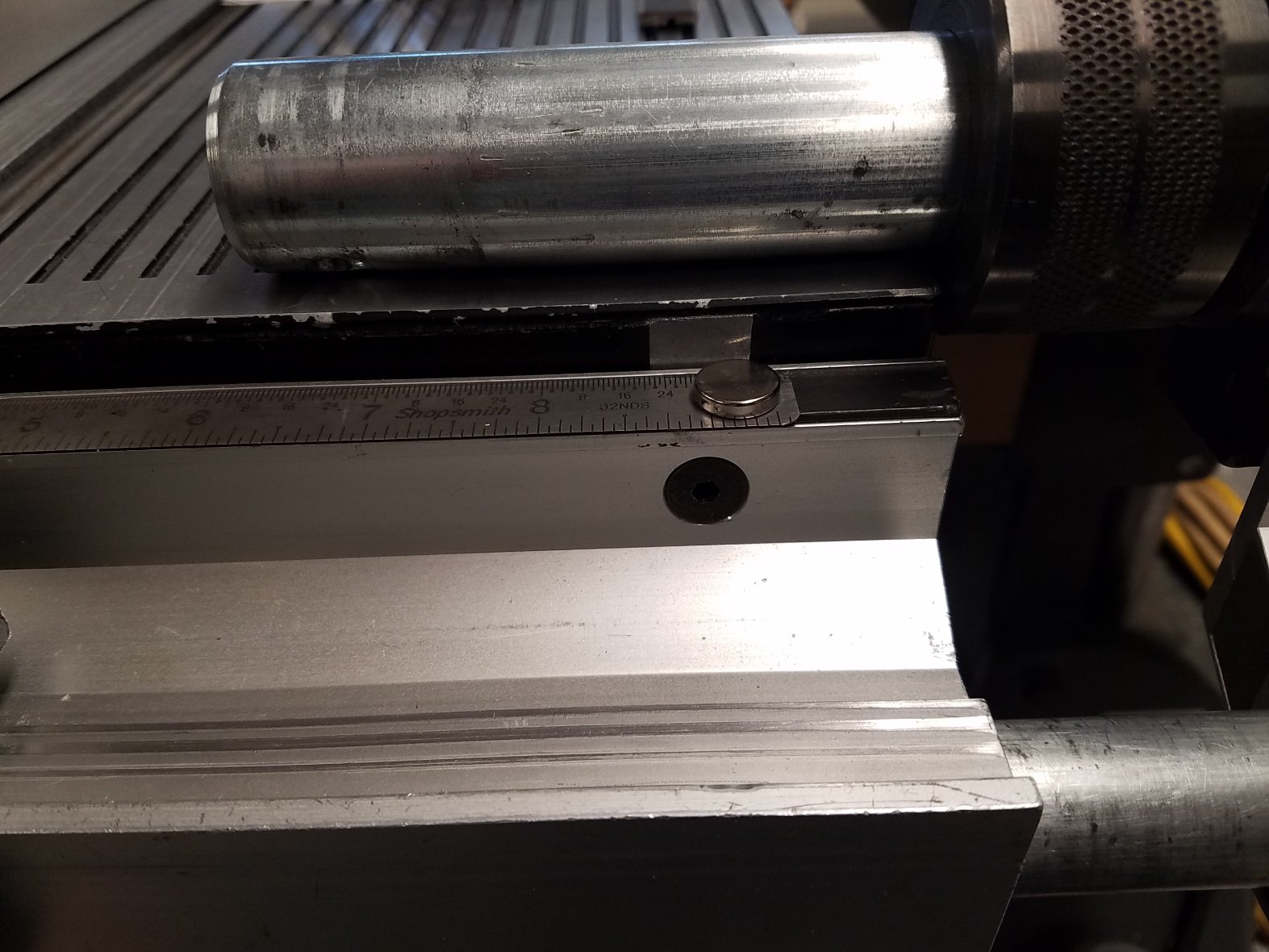

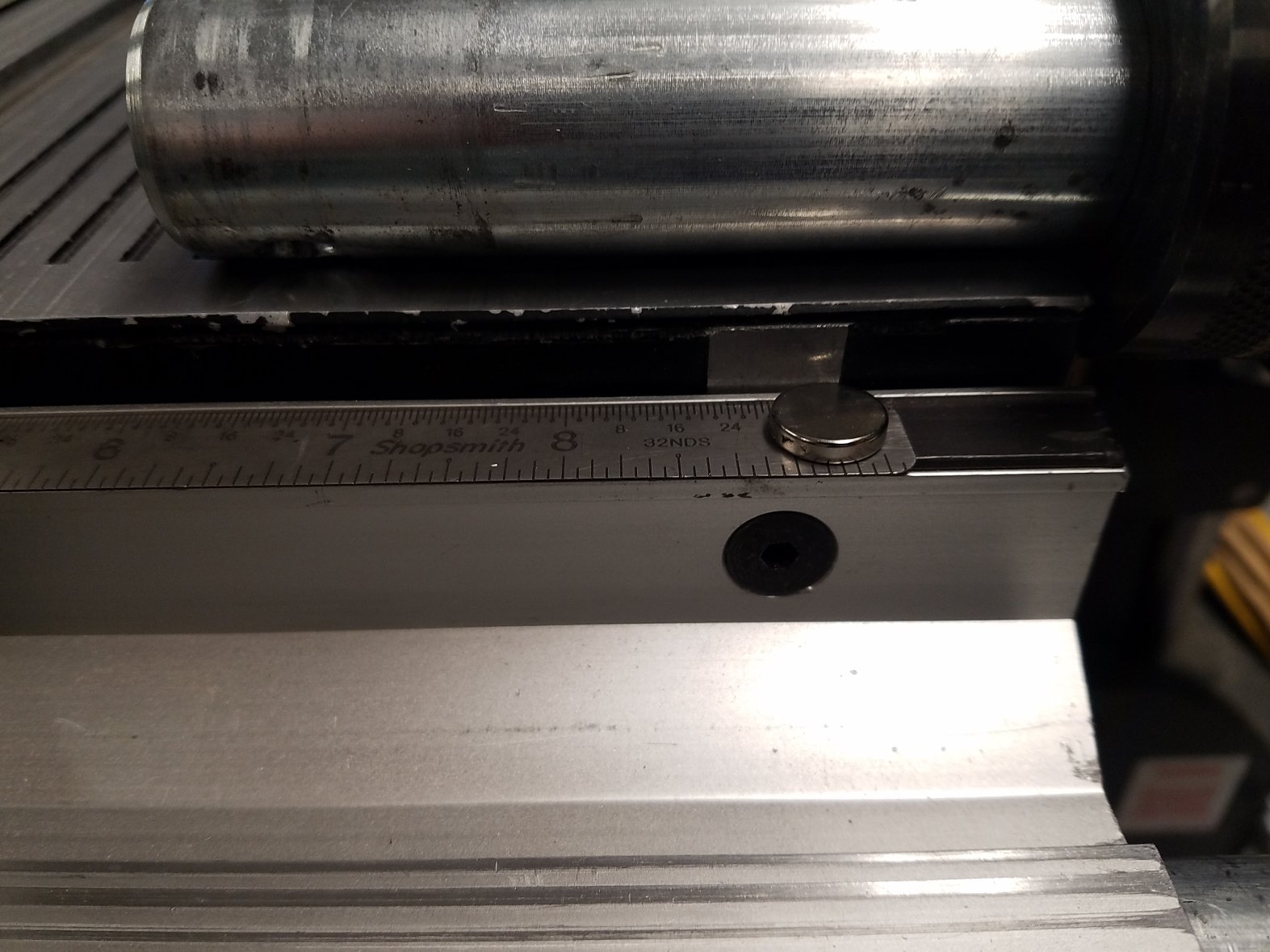

When I use the steel ruler on the Shopsmith the fence is hardly ever at either end of the front rail. This means that there is room at the ends of the ruler where magnets can be installed. I have installed magnets as a test. My mag tapes still have to be replaced.
