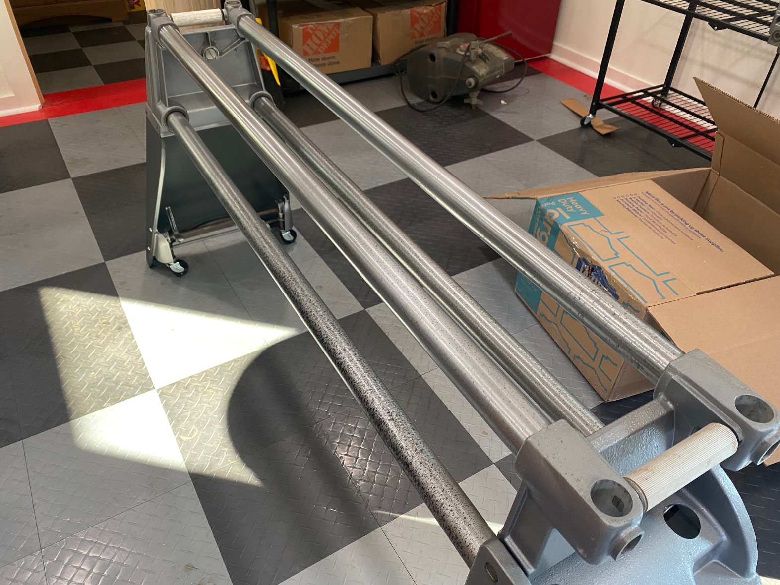

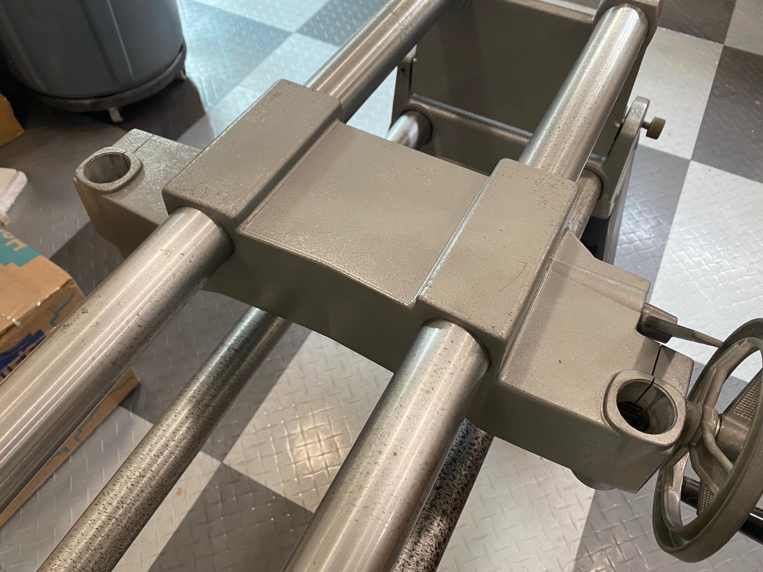

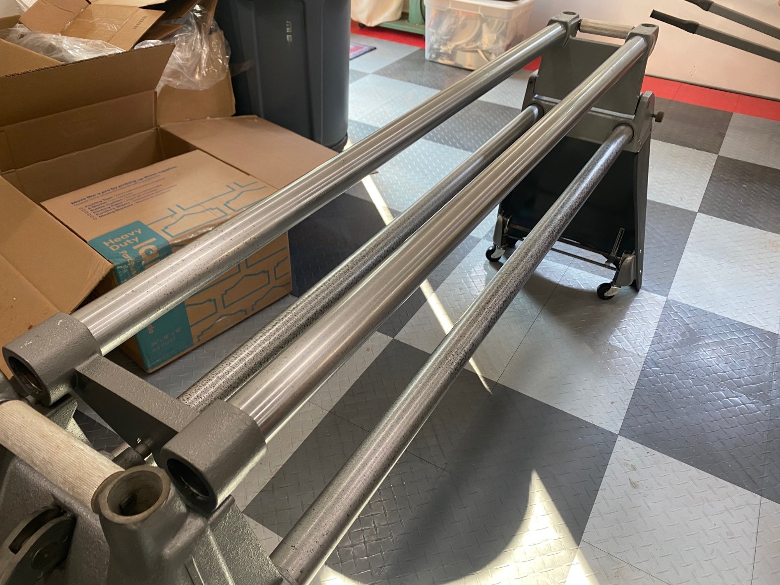

Got the way tubes cleaned up and installed today. They measure 48 inches between the castings, and equal on the diagonal.
Re: Refurbishing a MkV 510
And the carriage went on easily. Slides end to end with one finger and locks up nicely.

Ways = 48" Are the Bench Tubes the same? If you check all of the tubes for level, are they all identical? I think they should be but miner are not and I have been unable to make progress toward that objective.
My bench tubes are about 52 1/2dusty wrote: ↑Tue Sep 14, 2021 6:18 pmExcellent. Looks kike a real nice machine in the makings.
I had to put a turn and a half or so on the adjuster under the tie bar, but everything is level and square.

With the way tubes locked down, the critical thing is the 'angle' across the two way tubes is the same at both ends(twist). That big set screw is adjusted to achieve that.
A way to check that is the tailstock center point aligning with a drive center point on the quill, then moving the drive center to the top aux shaft and moving the tailstock to the other end. If the points do not align(front to rear), the way tubes are 'twisted'.

52 1/2" is the total length, correct. That should leave close to 48" exposed between the castings.John4337 wrote: ↑Tue Sep 14, 2021 6:31 pmMy bench tubes are about 52 1/2dusty wrote: ↑Tue Sep 14, 2021 6:18 pmExcellent. Looks kike a real nice machine in the makings.
You should be able to lift up on the Ways right there by the tie bar and not feel them lift.
