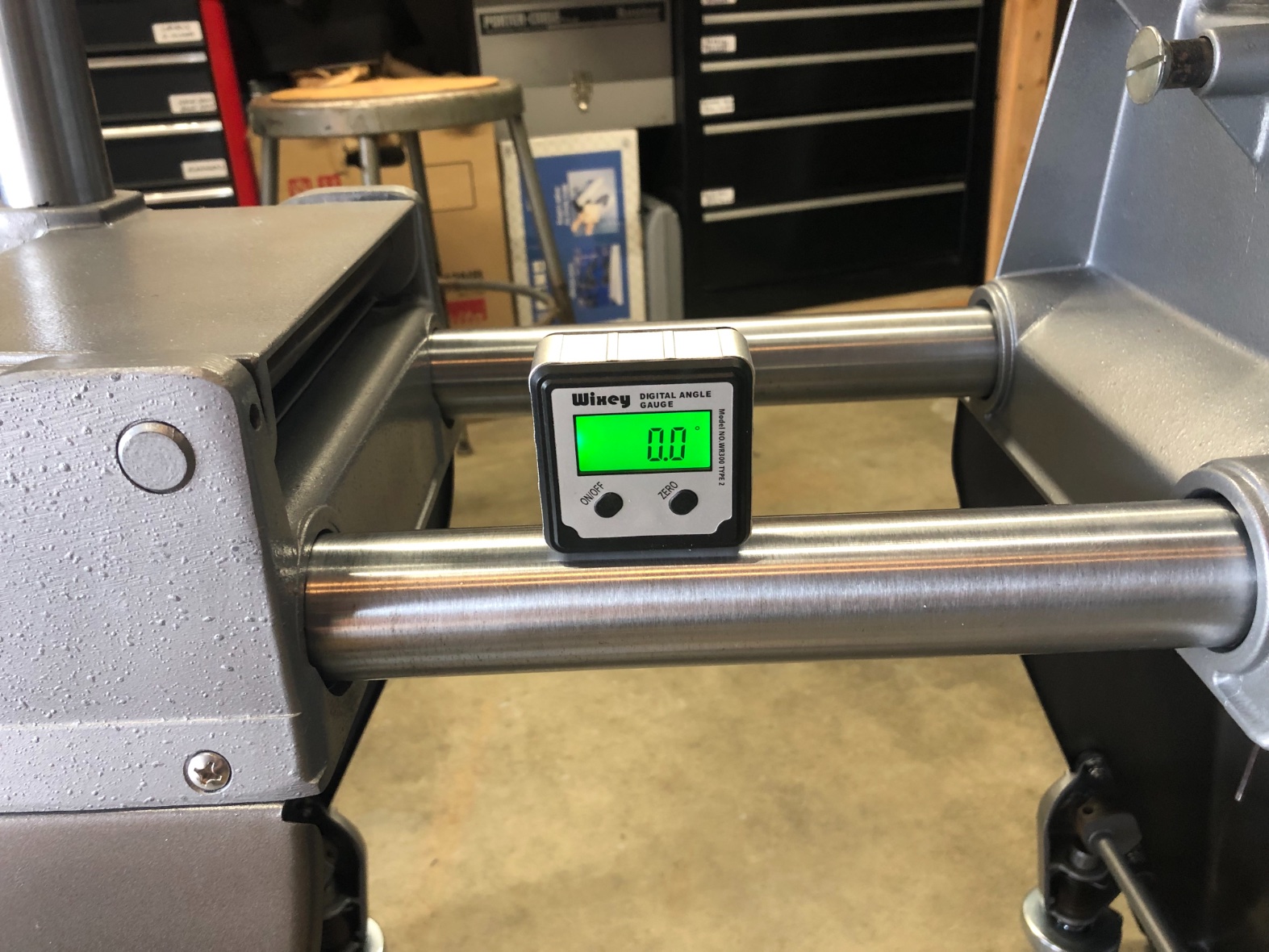

Yes, I zeroed the Wixie on the Bench Tube and measured 90.0 on the Way Tube.dusty wrote: Tue Sep 07, 2021 10:37 amAre you saying that you get a reading of 90.0 degrees after zeroing on a Bench Tube.DLB wrote: Tue Sep 07, 2021 9:50 amBoth of my Marks are Double TIlt so I ignored those but I mocked this up on a Base Assembly with a couple of short tube scraps and I measured 90.0 degrees with my Wixie. This was a new style Base with the smaller diameter hinge bar and setscrews on the 'top.' Is this angle, and/or deliberate under- or over-rotation, something that was changed at some point? I'll look around for another Base to try this on...dusty wrote: Tue Sep 07, 2021 9:14 am I have not read this entire thread but I must agree with you that your tilt is incorrect' ...

I measured this on a second machine with an earlier style base at 89.8 degrees. A small deviation from 90 degrees in the under-rotated direction. Here again, I zeroed the Wixie on the Bench Tube and measured on the Way Tube. This is an earlier Base, larger diameter hinge pin and less accessible set screws for holding the way tubes, I believe it to be from 1991.DLB wrote: Tue Sep 07, 2021 9:50 am Both of my Marks are Double TIlt so I ignored those but I mocked this up on a Base Assembly with a couple of short tube scraps and I measured 90.0 degrees with my Wixie. This was a new style Base with the smaller diameter hinge bar and setscrews on the 'top.' Is this angle, and/or deliberate under- or over-rotation, something that was changed at some point? I'll look around for another Base to try this on...

Re: Shorty Drill Press not perpendicular to floor, any ideas?

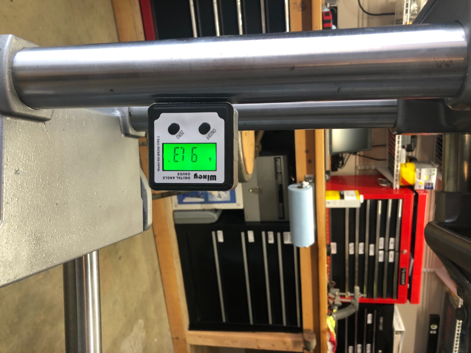

Ed- it’s bottomed out and still leans towards operator-
Here are a couple pics with zero on bench tubes
- 9ECBDAC5-0931-4654-8964-2027FC08BB16.jpeg (476.24 KiB) Viewed 1960 times
- 748060D5-E422-40B1-98B7-C8FA8079A94F.jpeg (417.42 KiB) Viewed 1960 times
I’m going to take it apart and start over I think.
I'se cornfuzed. That looks like it is as expected(rotated OVER 90°)?????
What dos a level(plumb vial) look like rather than the Wixey?
Wait, now seeing the above from JPG I don't know if I'm confused now. The vertical assembly should be able to over-rotate past 90°. I have no idea what the 91.3° on the level thingy means, which direction is less than 90° on that thing?
The confusion is coming from where he placed the Wixie in the second photo (note that the photo is posted sideways); he should have placed on the left side of the way tube. If you look at the first photo, it is on top of the bench tube, and it should be moved to what would normally be the top of the way tube, as if you just moved it up before raising into the vertical.
Aah, could it possibly be over rotated by 1.3 degrees. That is what is indicated to me. Find the little arrow to see what direction the Wixey was rotated from zero.edma194 wrote: Tue Sep 07, 2021 1:23 pm Wait, now seeing the above from JPG I don't know if I'm confused now. The vertical assembly should be able to over-rotate past 90°. I have no idea what the 91.3° on the level thingy means, which direction is less than 90° on that thing?
