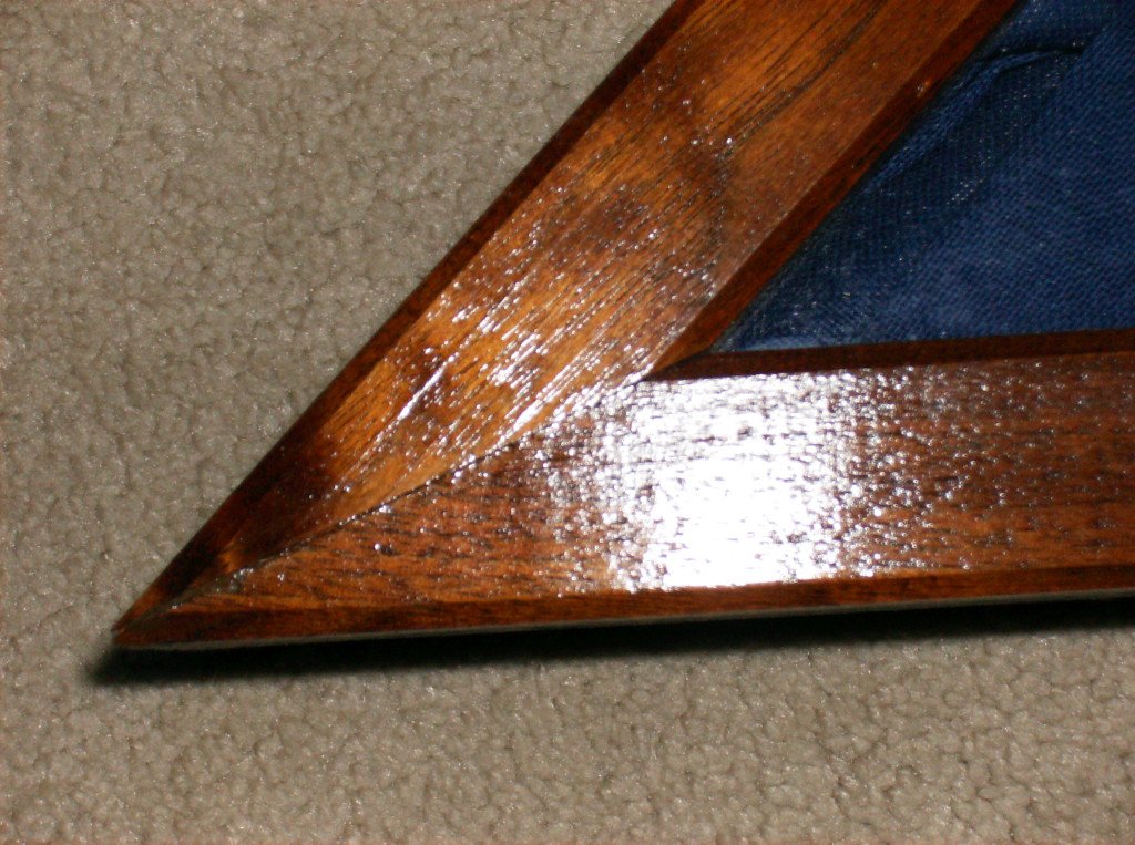

I didn't find it particularly challenging to cut those 22.5 degree angles when I made up a few display cases. I simply set my miter gauge and ran scrap wood through. I cut 4 of them and laid them together in my metal square. Once I found the right angle for the miter gauge that gave me 4 peices that made exactly 90 degrees, I cut the good wood at that angle.
They fit like this when done. No special equipment or setup is needed if you have a table saw and miter gauge.

garys wrote: Tue Dec 14, 2021 10:45 am I didn't find it particularly challenging to cut those 22.5 degree angles when I made up a few display cases. I simply set my miter gauge and ran scrap wood through. I cut 4 of them and laid them together in my metal square. Once I found the right angle for the miter gauge that gave me 4 peices that made exactly 90 degrees, I cut the good wood at that angle.
The part of this I can't visualize is not the finished product, which looks fine. My SS miter gauge does not swing to read 22.5 degrees, the angle that I think is necessary to make this cut with a miter gauge. (It starts at 90 degrees for a crosscut, which I now understand is not standard as some start at 0 and some show both scales.) It swings a couple of degrees below 30, so the most acute cut angle is ~28 degrees. And I also can't visualize the cuts you made where four pieces were laid into a square to make exactly 90 degrees. When I read that in your earlier post I thought it was a different set of plans. I have done the same thing with three pieces when making some octagons, the 'other' 22.5 degree miter. (I don't think this is strictly necessary, I'm happy with measuring the result of two pieces with a combination square or protractor.)

I used the Shopsmith miter gauge. First I cut a 45 degree piece of scrap wood and attached it to the miter gauge. From there, it was simple to adjust the miter gauge to get the rest of the 67.5 degrees needed. A basic Shopsmith and some scrap wood can do just about anything you need to do.

garys wrote: Tue Dec 14, 2021 12:35 pm I used the Shopsmith miter gauge. First I cut a 45 degree piece of scrap wood and attached it to the miter gauge. From there, it was simple to adjust the miter gauge to get the rest of the 67.5 degrees needed. A basic Shopsmith and some scrap wood can do just about anything you need to do.
That’s a clever way to extend the angular range of a miter gauge! I don’t think I’ve ever heard of the technique before.
Granted that it’s just semantics, but I’d argue that the 45 degree piece of wood that you attached to the miter gauge is in fact a simple jig — whether or not it was made from scrap wood. Per Merriam-Webster, in the sense that woodworkers use the word, a jig is “a device used to maintain mechanically the correct positional relationship between a piece of work and the tool or between parts of work during assembly”.
But regardless, simple is good. And your simple jig has an advantage over a sled, in that it doesn’t reduce the available depth of cut.
The OP's plans adds a complicating factor, the finished width of the pieces appears to be 4". Which IIRC exceeds the depth of cut of my preferred brand of TS to cut this as a standard miter. I can't imagine that alone is why it is cut on end and as a bevel though.
- David
I was puzzled at first by the part about four pieces making 90 degrees too, David. I was envisioning them being connected in a joint-to-joint serial chain, as in an actual frame. But it finally dawned on me that garys must have been assembling the test-cut pieces like segmented wedges. So a pair of them makes a 45 degree wedge, and four of them make a 90 degree wedge. That’s actually a great way to measure the angle, as any error in the angle of the individual wedges is multiplied four-fold before being checked against the square. It’s roughly analogous to William Ng’s 5-cut method for zeroing sled fences.
