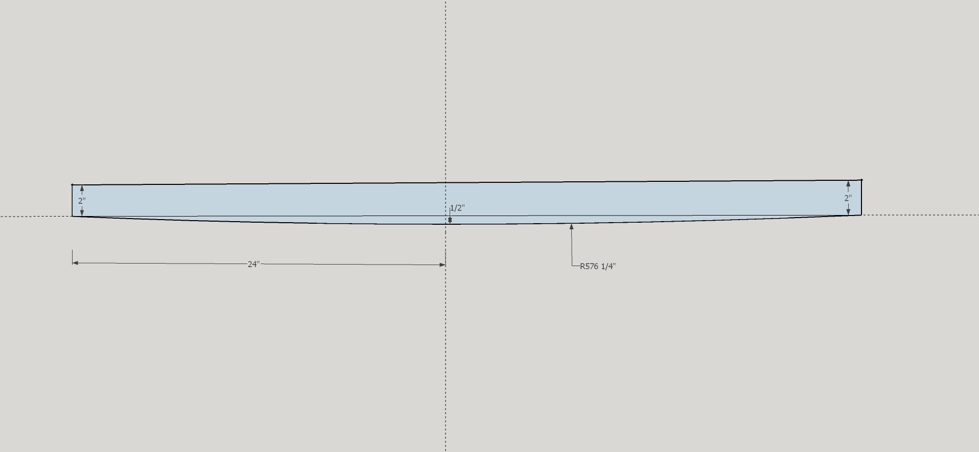

- Posts: 21481
Re: SS Panel Clamps
Does this represent what is being discussed here?
- BuckeyeDennis
- Posts: 3800
- Location: Central Ohio
Re: SS Panel Clamps
Close, if you're talking about the measurements that I took of my 48" clamps. The main difference is that the "height" of the arc was 1/8" on my clamps. (I actually measured a 2-1/8" total caul height in the middle, and subtracted the end height to arrive at the 1/8" arc height). It appears that you have the arc height dimensioned as 1/2".
Of little consequence, I measured the caul heights across 47" of arc, not 48". That will cause a slight difference in the calculated radius.
