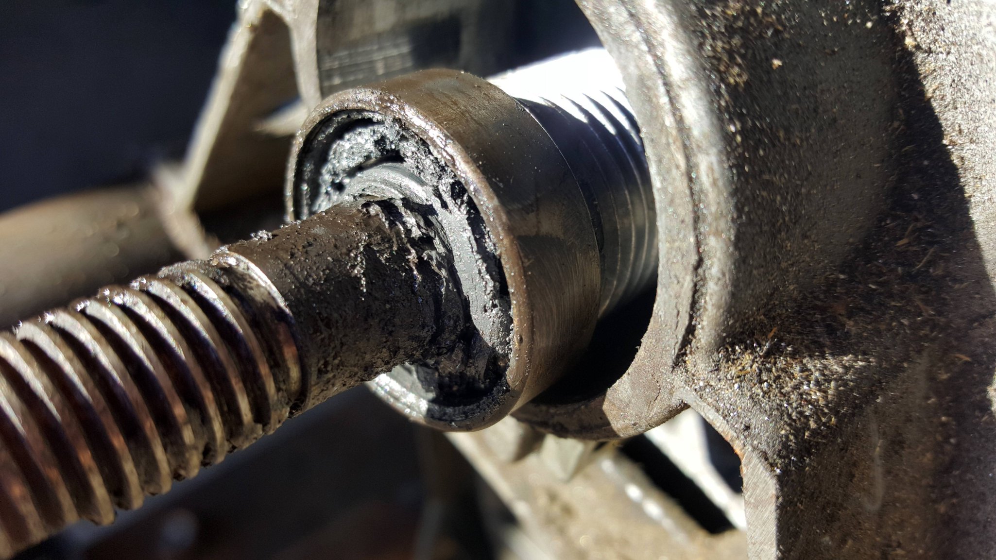

I got Pollux apart for belts and bearings and I found the dragging problem. the intermediate shaft bearings inside the eccentric are trashed. One is almost seized, and the other is shedding bearing balls - which, is not conducive to smooth operations. Will rebuild it and stuff it back together. The quill and main bearings were in very good shape, and just cleaned and left in place.

I hope the idler shaft is OK!!!! I have one that the bearing trashed the shaft.
Hope thee greased the bearings after cleaning!

It be ugly in there. My belts arrived today. Pollux will be back online late next week. I'm headed to CO for some vacay skiing.
I have to take the motor out to get the aux shaft and sheave out, then press the bearing off and new ones on. Not too bad of a job, but the belt routing and removal/install is wicked. Very tight tolerances forming the belts around stuff.
