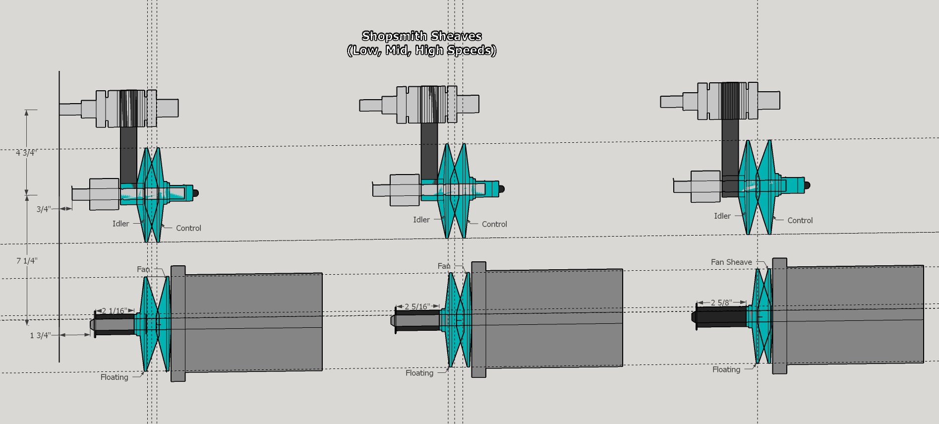

With the speed control set to slow, if the motor belt is installed, the motor
sheaves (Fan and Floating) should be wide open. The motor belt riding at the outer edge of the
upper (Idler and Control) sheaves.
?????If I manually pull the motor Sheaves apart it will run until the motor Sheaves start to close.????? How do you achieve this??

dusty wrote: Fri Feb 04, 2022 11:14 am
With the speed control set to slow, if the motor belt is installed, the motor sheaves should be wide open.
The motor belt riding at the outer edge of the motor sheave.
Did you mean: motor belt riding near the outer edge of the
idler sheave?

Thank you for correcting me. I did not say what I was thinking.
A picture may be more helpful:
- Sheaves and Shaft a Comparison.jpg (163.37 KiB) Viewed 1218 times

dusty wrote: Fri Feb 04, 2022 3:10 pm
Dusty - On a sample of one machine here, the sheaves move much more than your drawing depicts. I'm looking at the distance from the motor shaft washer to a point on the floating sheave, essentially the length of the spring at a given amount of compression. At high speed my machine matches the drawing, 2-5/8". But at low speed my machine is ~ 1/3/8" while the drawing shows 2-1/16". Sheave travel is over 2X compared to the drawing. I don't mean to nit-pick, the focus of this thread is low speed startup. As you said earlier: spring fully compressed and belt riding near the outer edge of the idler sheaves, that's when I'm getting the 1-3/8".
JACOBEIS - From your description it sounds like your machine may be indicating slow but the sheaves/belt are not actually in the slow position. That would be a different problem than most of this thread is talking about. Also a
much simpler problem to diagnose and solve. Can you confirm?
- David

DLB wrote: Sat Feb 05, 2022 9:11 am
- David
All I can offer in response is that this drawing depicts the measurements of one of my machines and nearly matches the other. In addition to that, I have a new motor with sheaves and the measurements there match the drawing.
How deep the belt moves down into the floating sheave is a function of belt dimensions. This would affect the sheave separation and thus the degree of spring compressions.
I have 1 1/2HP Emerson motors. The spring is retained on the shaft in slightly different manner on other machines. Might that contribute to the differences. Also. I measure from the face of the sheave to the inside of the washer - the the spring itself. That may explain. However, the delta between your measurements and mine appear to be greater that would would be caused by technique.
My sketch redrawn to match your dimensions. I'm without explanation! I cannot get that separation between the sheaves (1 3/4") even if I fully compress the spring.
