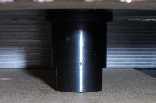

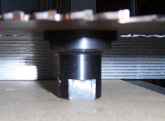

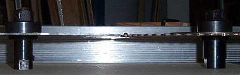

[quote="keakap"]ShopSmith sold at least three different arbors under the part number 505506, which is the number used today for the Moldy/Dado arbor. At least one variant was called the "Universal Arbor" (I use one with a wobble dado blade and another (different) with a blade w/stabilizer) and with the different washers and spacers provided any (5/8) saw blade can be used and positioned almost* the same as with the SS arbor, I believe.
Some differences: body-- different thickness]
To compare, I mounted 5/8 blades to the two different "Universal" (505506) arbors, and took some pics, also of a SS 1-1/4 arbor.
"Item no. 505506 ShopSmith 5/8" Universal Arbor"
[ATTACH]6080[/ATTACH]
the second 5/8 Universal, later vintage
[ATTACH]6081[/ATTACH]
the SS 1-1/4 arbor
[ATTACH]6082[/ATTACH]
and a side-by-side of the 2 505506's
[ATTACH]6083[/ATTACH]
The biggest difference between the two Universals= the body diameter. All three have different diameters, btw. A minor difference between one Uni and the other is length, by ~1/64 (can be seen in the last picture).
The other 505506 is today's Moldy/Dado arbor, which is longer and comes with a 3/4" spacer instead of the 5/8 spacer.
SS 510 Univ B.jpg (129.7 KiB) Viewed 2082 times
SS 510 Univ A.jpg (100.72 KiB) Viewed 2079 times
SS 510.jpg (48.13 KiB) Viewed 2077 times
