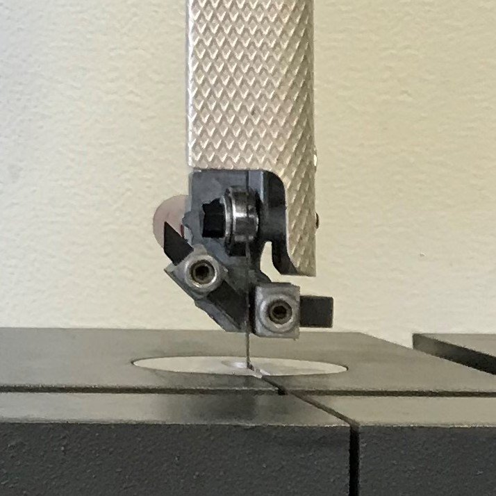

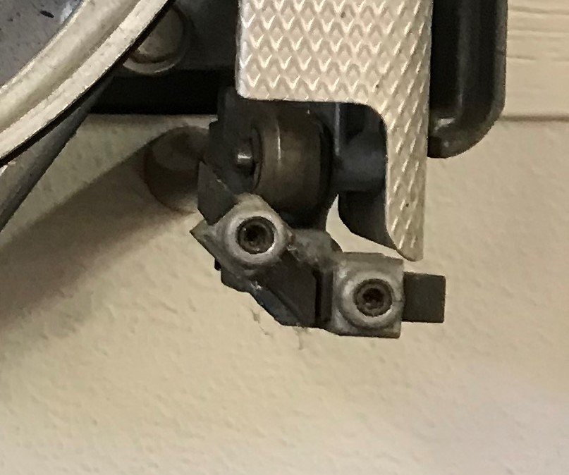

David,
I don't have any measurements for you but below are pictures of the Upper Roller Guide and Upper Bearing Guide for comparison. These are both pictures from the same Bandsaw as a before and after the change. The 1st picture is the Roller and the blade tracks to the right side. You can kind of see a mark where it tracks at 1/3 of the roller to the right and 2/3 of the roller to the left. The 2nd picture is the Bearing and the blade tracks very near the center.
_
Bandsaw Upper Guide - roller.jpg (74.2 KiB) Viewed 2065 times
Bandsaw Upper Guide - bearing.jpg (76.03 KiB) Viewed 2065 times

The Bandsaw in my pictures above is one I restored and is from January 1984. It has the current Backup Roller Retrofit Kit bearings. Both my 2006 and my 1998 Bandsaws have wider bearings for the upper and lower guides. I believe in both cases they are original. The 2 stacked Auto Tracking bearings look to be the same size as the current Kit bearings. I believe the change was made at some point to have all 4 Bearings in the Kit be the same width to make it simpler since the narrower bearings work just as well for the upper and lower Guide Bearings. In the 1984 Bandsaw the blade tracks in the center of the guide bearings while in my 2006 and 1998 Bandsaws the blade tracks a bit to the right on the guide bearings. In all three Bandsaws the blade tracks in the same position over the bearings. The use of the flat washer has no effect on the position of the bearing relative to the blade since, if used, it goes on the shoulder screw first before the bearing. Since I have not had any problems with the bearings in either my 1998 or 2006 Bandsaws, I have not taken those assemblies apart, so I hope I am not missing something here.
I have two versions of the instructions. The earlier one is 845010 Rev. 9/84 does not include the flat washers whereas the current instructions Pl-5101 9/84 does. In the earlier instructions the "Roller" Bearings for the upper and lower Guides have a different part number from the 2 Auto Tracking Bearings which is the same part number as the 4 current bearings. I don't know the actual age of the earlier instruction sheet.
