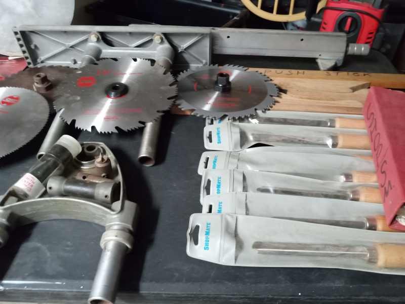

Your Shopsmith collection includes both old and newer parts. The Lathe Steady Rest being one of those newer items. I did spot an interesting Item which is circled in the copy of your picture below. It is the original power coupler used to connect the Jointer and Jig Saw to the Mark 5 Headstock for power. It does not use the Metal Hubs like all other Power Couplers made since the introduction of the Belt Sander in 1955. Instead it uses a set screw in each end to lock on to the 5/8" drive shaft of the Headstock and the 1/2" drive shaft of the Jointer or Jig Saw. Because the Belt Sander and the Bandsaw which followed both have a 5/8" drive shaft the Power Coupler was redesigned to use Hubs to work between the different SPT's. If you want to use other SPT's like the Belt Sander or Bandsaw you will want to change to the newer Power Coupler setup with Hubs. Depending on the condition of the rubber in the old coupler it could break at any time during use. Remember it is at least 67 years old.
