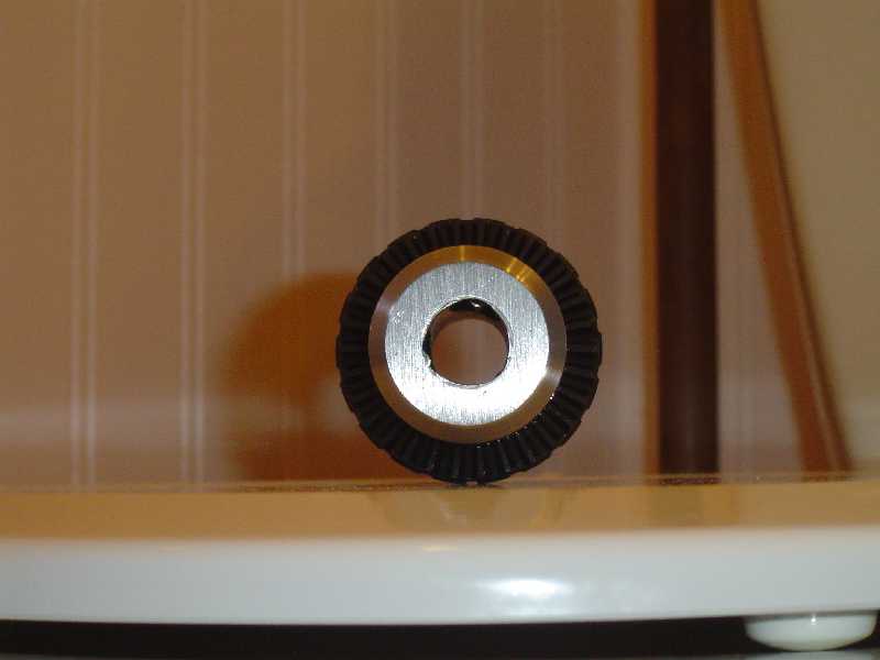

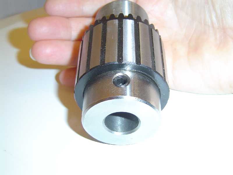

Here they are, Dusty. Now you have something to put into my file.dusty wrote:I wonder....what does this chuck look like? Sure wish I could see some of those photos, the ones that Jacobs looked at.
- Chuck exterior set screw (downsized).JPG (35.38 KiB) Viewed 14140 times
- Chuck interior set screw (downsized).JPG (37.22 KiB) Viewed 14140 times
- Chuck jaws opened (downsized).JPG (35.98 KiB) Viewed 14140 times
- SS Chuck (downsized).JPG (55.05 KiB) Viewed 14140 times
Tim
- a1gutterman
- Posts: 3653

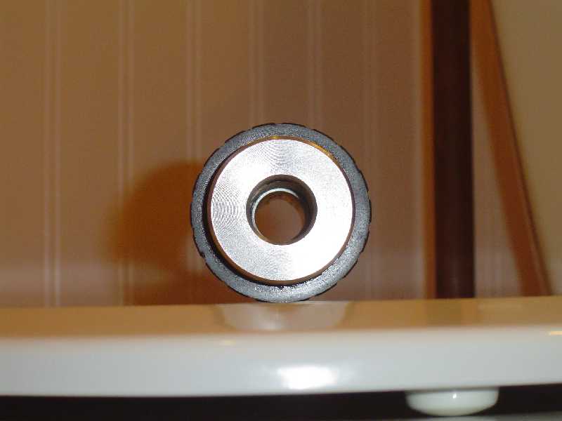

Your wish is my command. It looks a lot like the chuck that hobbyist already posted on this thread in post #21 and said it was a Jacobs model 3326. Now you have something to put into my folder.dusty wrote:I wonder....what does this chuck look like? Sure wish I could see some of those photos, the ones that Jacobs looked at.
[ATTACH]3185[/ATTACH]
[ATTACH]3186[/ATTACH]
[ATTACH]3187[/ATTACH]
[ATTACH]3188[/ATTACH]
[ATTACH]3189[/ATTACH]
These are the exact pictures that I sent to Jacob's, and Mike said that it was not a Jacobs chuck. I do knot know how he could tell this, as it sure looks like a 3326!!!
- Chuck exterior set screw (downsized).JPG (24.86 KiB) Viewed 14314 times
- Chuck interior set screw (downsized).JPG (20.86 KiB) Viewed 14310 times
- Chuck jaws opened (downsized).JPG (20.85 KiB) Viewed 14311 times
- Chuck spindle end (downsized).JPG (23.34 KiB) Viewed 14312 times
- SS Chuck (downsized).JPG (41.13 KiB) Viewed 14309 times

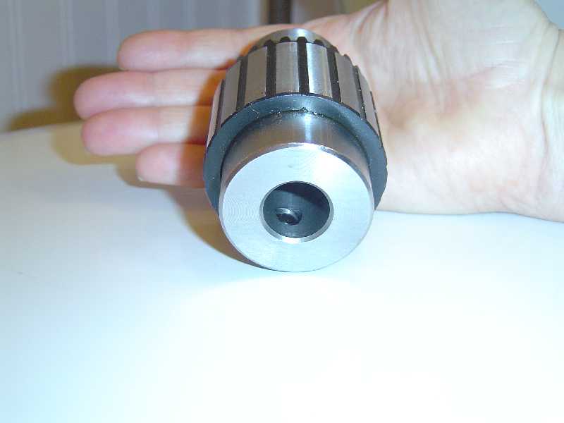

Mine, also is a 1995 Mark V. But if the jacobs 3326 has a solid center, that is how Mike at Jacobs knows that my chuck is knot a Jacobs.judaspre1982 wrote:I have four SS chucks and three are stamped with Jacobs ID info and one has only the SS logo and looks like the one Tim has posted. It seems the one that has just the SS logo is bored completely thru the chuck as you can see in Tims pics and the others that bare the Jacobs info are solid in the middle. I would like to know if hobbyists chuck in post #21 is solid or hollow. It seems as tho Jacobs likes to have their name stamped on their products , even their keys. The chuck I have that has just the SS logo has no other identifying info even on the key. This chuck is off of a 1995 era MK V.-----Dave
Tim

Thanks, Dave. Mike @ Jacobs has already told me that Jacobs no longer makes the Multi-Craft chuck MC8K26. I have not received an answer to my recent e-mail to him asking about the 3326. Their on-line information does not show a 3326, but it does show a 3326A, which Mike tells me requires a key to hold it into place on the spindle rather then a set screw and a left hand threaded screw down the center.judaspre1982 wrote:Tim, two are identical and came with 1955 machines and are the 3326 Jacobs. One is the Jacobs-Multi- Craft - Chuck and has MC8K26 stamped on it. It is solid in the middle and smooth not knurled as posted earlier in this thread. Its key however will fit the 1995 SS chuck perfectly while the other keys will not. The Jacobs MCC came with one of the 1955 MK V purchases but I do not know when it was manufactured. The key for the MCC is stamped KK.-------Dave
[quote] [align=left]Tim,
This is a key drive chuck. It does have a 5/8" straight taper, but it's only a slip fit condition. You would still need to have a key perpendicular to your shaft to drive the chuck and a left hand threaded hole in the center of your shaft for the retaining screw to keep the chuck on the shaft. I think the attach drawing will help you understand how the chuck needs to be mounted.
Thanks,
[/quote][/color][/SIZE][/font]This is a key drive chuck. It does have a 5/8" straight taper, but it's only a slip fit condition. You would still need to have a key perpendicular to your shaft to drive the chuck and a left hand threaded hole in the center of your shaft for the retaining screw to keep the chuck on the shaft. I think the attach drawing will help you understand how the chuck needs to be mounted.
Thanks,
[/align]
He sent me a spec sheet on the 3326A, but it is knot clear enough to make out when I resize it to fit on this forum. If anyone wants the spec sheet on the 3326A, PM me your e-mail address, and I will send it to you.
Tim

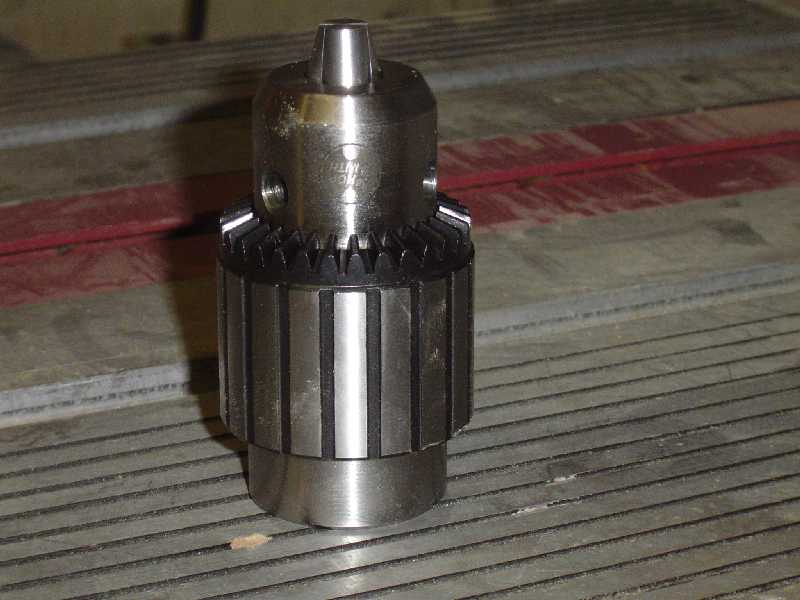

My Jacobs 3326 (apparently mid 50's vintage) is solid. Here's some close-up photos...judaspre1982 wrote:I would like to know if hobbyists chuck in post #21 is solid or hollow.
I've read that the older of the Jacobs 3326 chucks are the ones stamped "Hartford Conn". There are quite a few informative posts about Shopsmith chucks on the Yahoo SSusers group. Here's one of them...
