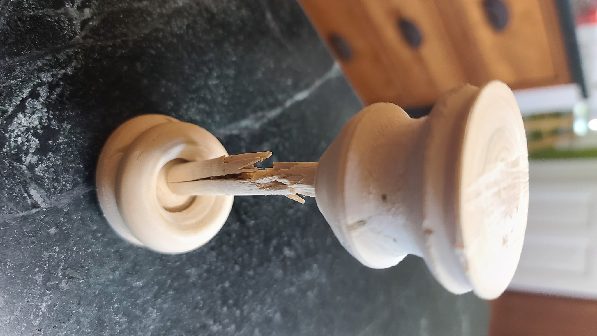

I've started fiddling around and getting familiar with the set of Wards gauges that came with my SS.
I turned a piece of green maple that came from a tree in my yard, i was very happy with how the ring separated but then i got greedy with a gouge and snapped the spindle as i was finishing the piece up.

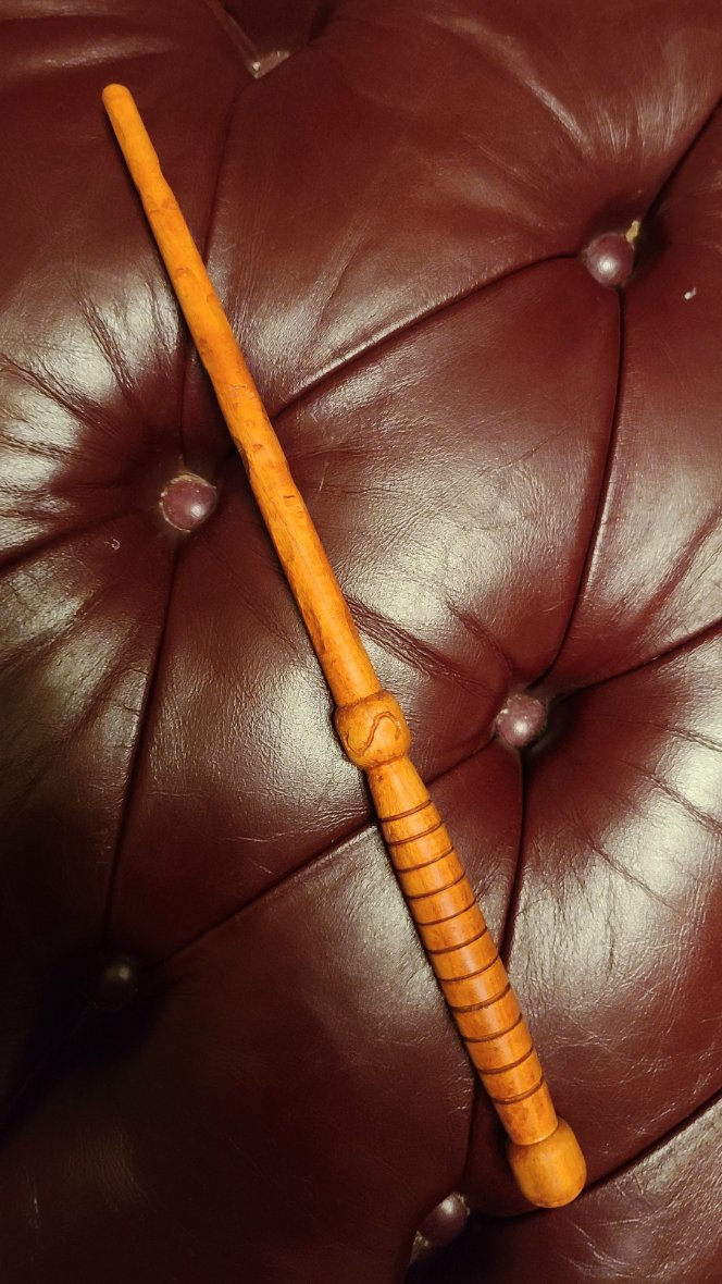

But then i cut a blank from some air dried cherry i have and something magical came out for my eight year old.

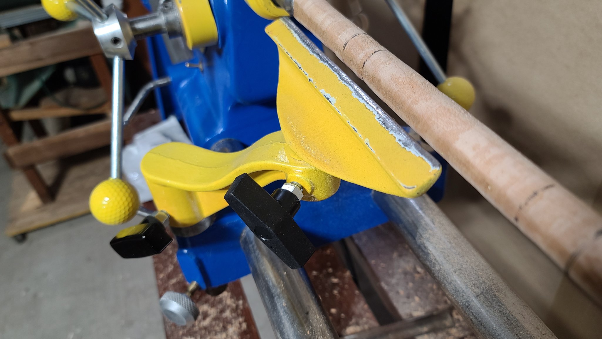

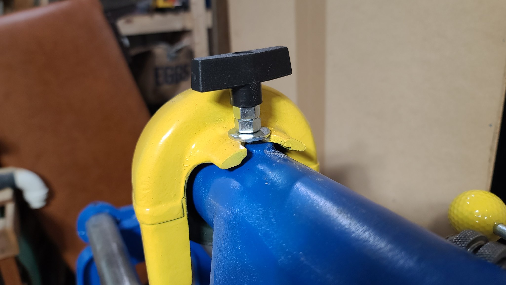

More minor upgrades today
Quick release handles for the tool rest make adjustments much easier.
Another one for the belt cover for changing gears.

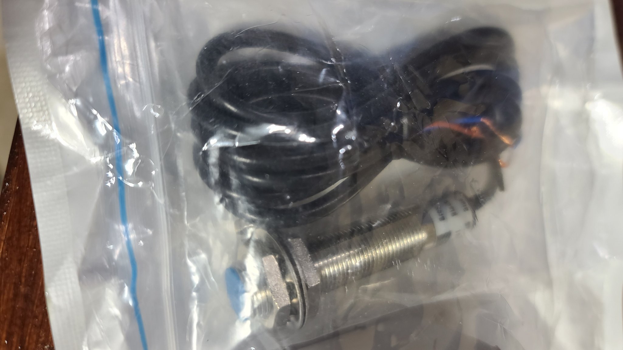

And finally an rpm display that i will install at the back of the motor.
I am.still looking for an autotransformer to fine tune the speed as needed.

Looks like things are coming along nicely. Can you tell me where you got the RPM display and how exactly it works/hooks up?

DarrenDD wrote: Sat Aug 13, 2022 9:11 pm Hi Joel,
Hi Darren, and thanks.
I got the rpm sensor from Amazon. This one is barebones and a little tricky to hook up, but basically there is a small magnet i am going to glue to the gear on the back of the SS headstock. Then drill a hole in the headstock to mount the sensor right where that magnet will spin past it.
Then the display will need some kind of little mounting box where i can see it, and everytime the magnet passes the sensor it will display how many times per minute it is going by on the gear (rpm)
It will also need a small power adapter.
EEEkit 4 Digital Red/Blue LED Tachometer RPM Speed Meter + Hall Proximity Switch Sensor NPN Led Panels Digital Led Module https://a.co/d/3eCN4Eq
