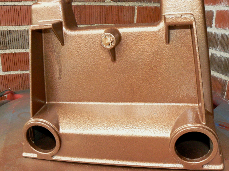

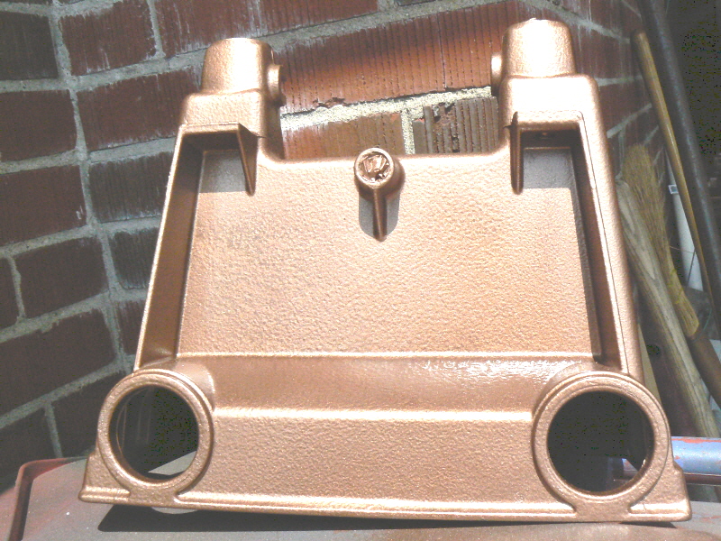

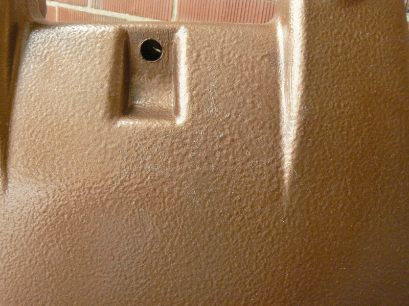

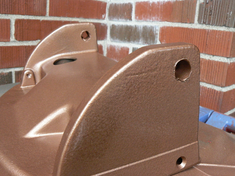

The parts below were painted wirh rustoleum hammer tone copper. I have attempted to illustrate the fairly forgiving properties of this paint. The initial painting was done on a WINDY day(the rain WAS coming) and the spray can was held VERY close. This resulted in runs and funky finish. Two examples are in this post, and two more in the next post(by me).
The prep on the end castings was minimal(Brief Light Sanding).
[ATTACH]4518[/ATTACH]
Obvious RUN
[ATTACH]4519[/ATTACH]
After 'fixing'(two passes)
[ATTACH]4520[/ATTACH]
Scratches showing through first coat
[ATTACH]4521[/ATTACH]
After a couple of overcoats.

- run 1.jpg (399.65 KiB) Viewed 4389 times
- run 1 final.jpg (396.34 KiB) Viewed 4389 times
- scratch.jpg (418.85 KiB) Viewed 4390 times
- scratch final.jpg (470.45 KiB) Viewed 4384 times

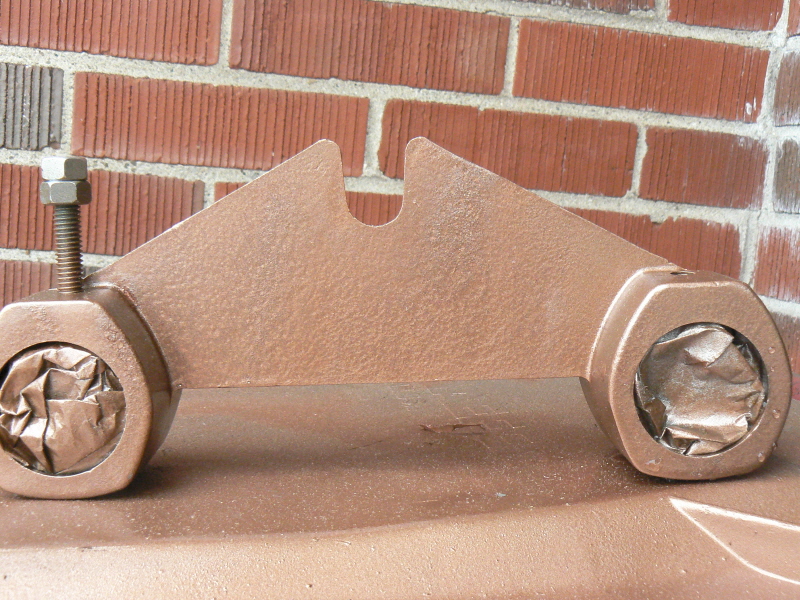

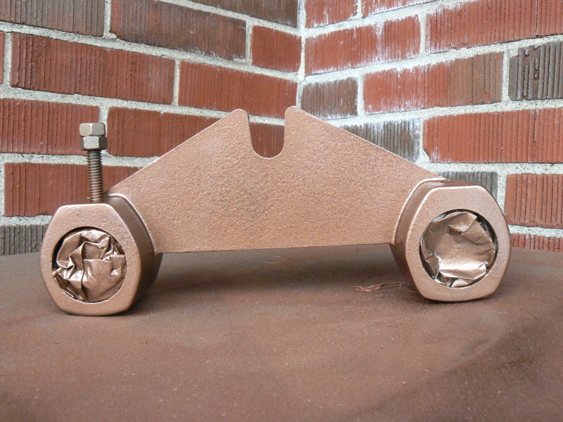

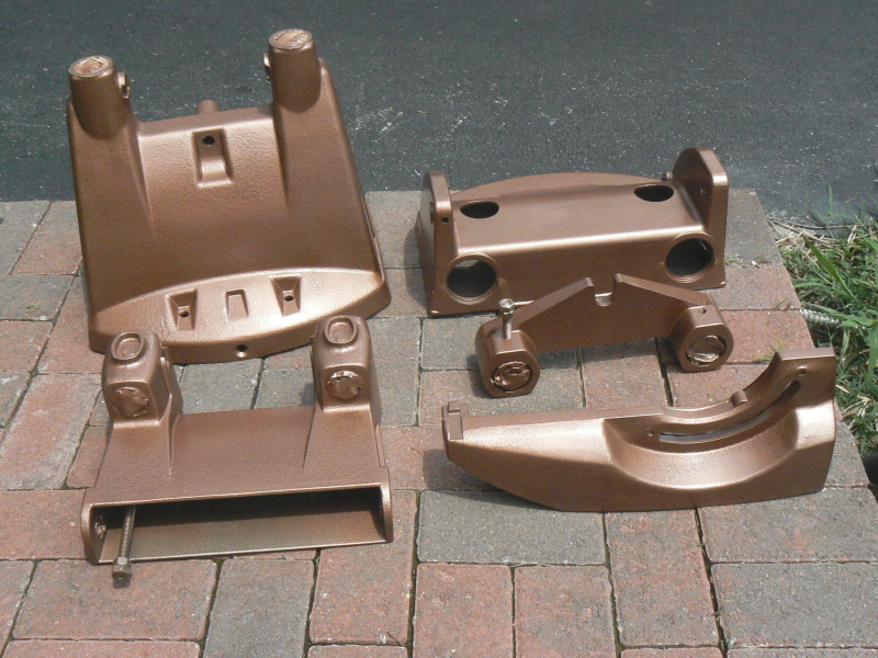

More 'forgiveness'

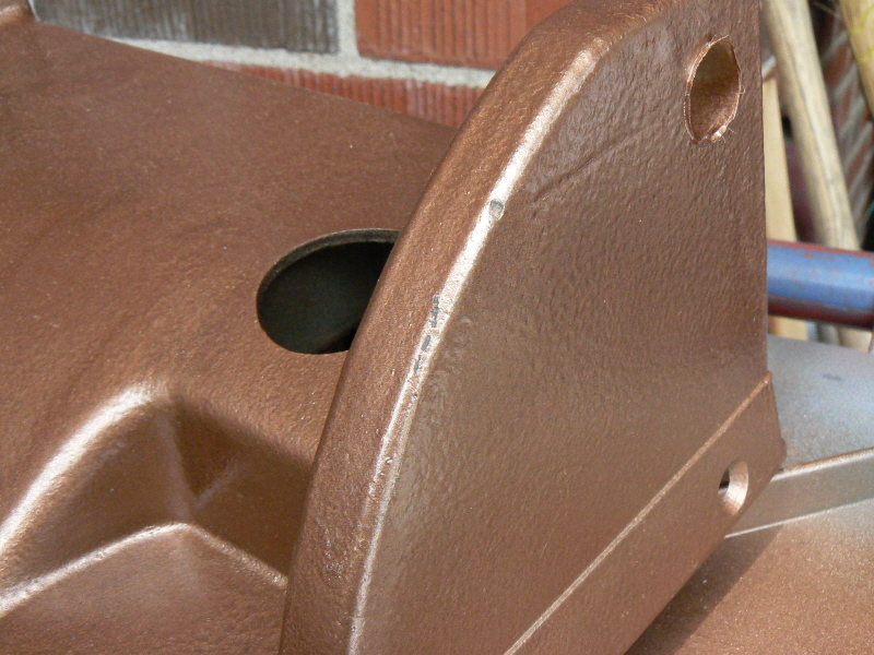

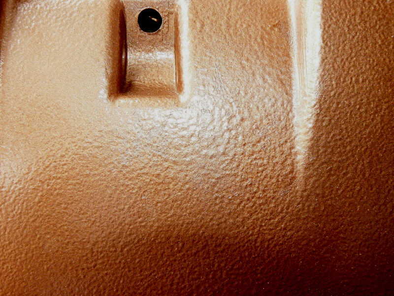

This is a continuation of a previous post illustrating the forgiving attributes of rustoleum hammertone copper paint. Shown below are a ding repair and a funky finish repair attempt.
[ATTACH]4522[/ATTACH]
Bumped it and dinged the edge
[ATTACH]4523[/ATTACH]
After a fix pass. I will do another pass to fill the 'hole'
[ATTACH]4524[/ATTACH]
Uneven pigment distribution
[ATTACH]4525[/ATTACH]
Not as successful as the others. I will be giving this another pass also
[ATTACH]4526[/ATTACH]
Group Portrait:)

Group Portrait:)
- ding b4.jpg (350.71 KiB) Viewed 4406 times
- ding.jpg (355.7 KiB) Viewed 4411 times
- funky.jpg (402.59 KiB) Viewed 4399 times
- funky final.jpg (387.65 KiB) Viewed 4405 times
- group portrait.jpg (379.69 KiB) Viewed 4397 times

JPG40504 wrote:The parts below were painted wirh rustoleum hammer tone copper. I have attempted to illustrate the fairly forgiving properties of this paint. The initial painting was done on a WINDY day(the rain WAS coming) and the spray can was held VERY close. This resulted in runs and funky finish. Two examples are in this post, and two more in the next post(by me).
I can really appreciate the difficulties you had spraying outside with even the slightest breeze. The paint is too sensitive for that as I found out also. Fortunately, I found out when doing test sprays on sheet metal. The two problems painting the any breeze is exactly how you described it, texture issues and running. That's why on paint day, I am outside at the crack of dawn and painting as soon as the light is adequate to clearly see. For me, today is paint day. Doing my jigsaw parts. It's 5:45am and I'm ready to go.
Nice close up shots. Good long depth of field obviously shows a smaller aperture used.
Sunny San Diego
Sunny San Diego
Close ups done in "macro" mode. You know the flower symbol.mickyd wrote:I can really appreciate the difficulties you had spraying outside with even the slightest breeze. The paint is too sensitive for that as I found out also. Fortunately, I found out when doing test sprays on sheet metal. The two problems painting the any breeze is exactly how you described it, texture issues and running. That's why on paint day, I am outside at the crack of dawn and painting as soon as the light is adequate to clearly see. For me, today is paint day. Doing my jigsaw parts. It's 5:45am and I'm ready to go.
