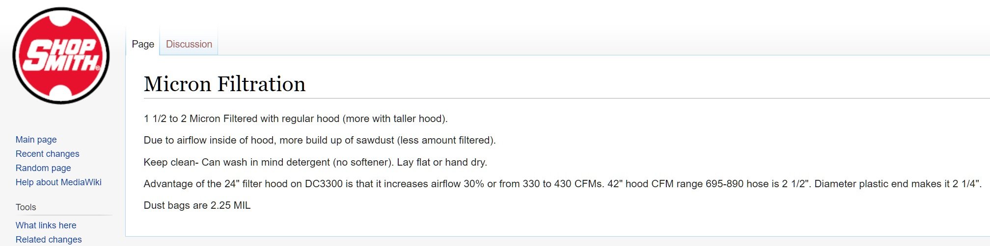

Also note that RFGuy and Dusty are using different filter hoods at the time they ran their tests, neither 'standard'. It is another unquantified variable. SS asserts higher CFM for larger hood: "Advantage of the 24" filter hood on DC3300 is that it increases airflow 30% or from 330 to 430 CFMs. 42" hood CFM range 695-890 hose is 2 1/2". Diameter plastic end makes it 2 1/4"." https://www.shopsmith.com/mediawiki/ind ... Filtration
- David
David,
Yeah, I wish you hadn't referenced that inaccurate Shopsmith Wiki link above. Shopsmith used to make the filter hood information readily available on their website, but recently I noticed they took it down or moved it. Below is a past Shopsmith catalog that details the filter rating differences between the 12", 24" and 42" filter hoods. The Wiki you reference has this wrong and claims 1.5 to 2µm filtering with the "regular hood". Shopsmith has listed the 12" filter hood as filtering down to ONLY 7µm for several years. The 24" filter hood goes down to 5µm and the 42" filter hood is rated down to 1µm. I know because I have looked it up umpteen times in the past. Given the inaccuracies relating to the filter hoods in your Shopsmith Wiki link, I don't know that I can trust ANY of the other info on that Wiki page.
Accurate Catalog Description:
https://www.shopsmith.com/ownersite/Mas ... 8-08r2.pdf
Inaccurate Wiki Description:
