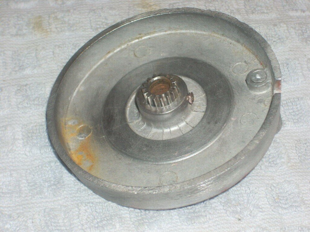

The picture below shows the back side of a Speed Control Handle. On the right side of the Handle you can see the notch to access the set screw. This is one set screw your 5/16" Allen Wrench aka the Shopsmith Toolbox does not fit.

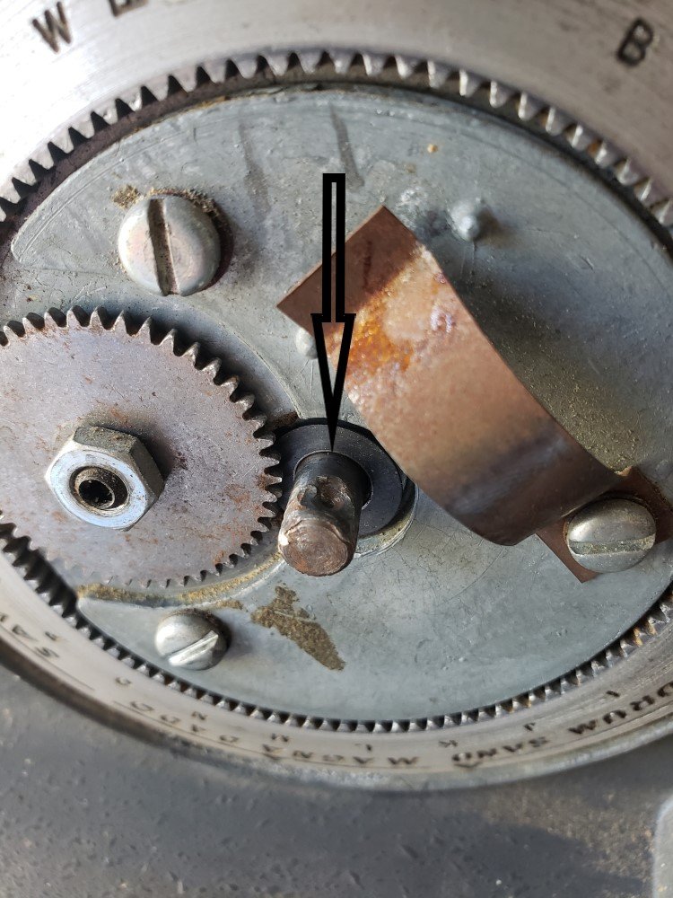

On the Speed Control Assembly shown below the arrow indicates the dimple on the shaft where the set screw of the Speed Control Handle should seat.

Re: Old shopsmith with a poorly replaced motor
"This is one set screw your 5/16" Allen Wrench aka the Shopsmith Toolbox does not fit."
That explains everything! Thanks Russ.
