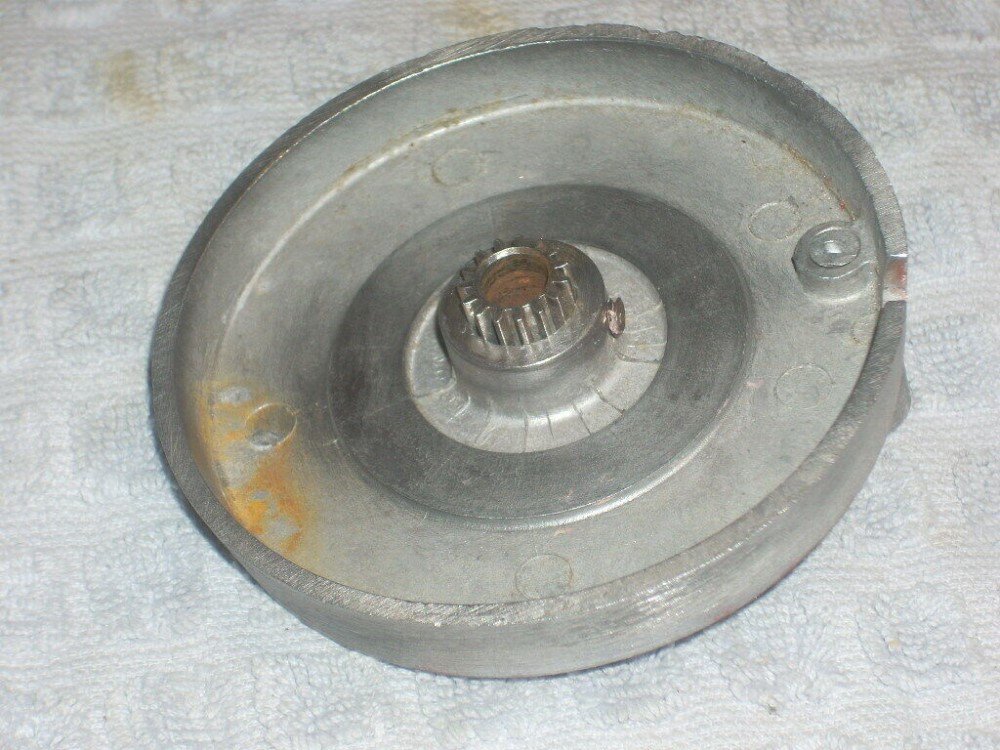

by chapmanruss
The picture below shows the back side of a Speed Control Handle. On the right side of the Handle you can see the notch to access the set screw. This is one set screw your 5/16" Allen Wrench aka the Shopsmith Toolbox does not fit.
_
Speed Control Handle - back.jpg (154.77 KiB) Viewed 1814 times

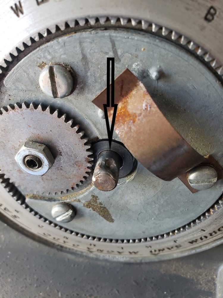

On the Speed Control Assembly shown below the arrow indicates the dimple on the shaft where the set screw of the Speed Control Handle should seat.
_
speed control - arrow.jpg (150.64 KiB) Viewed 1814 times
