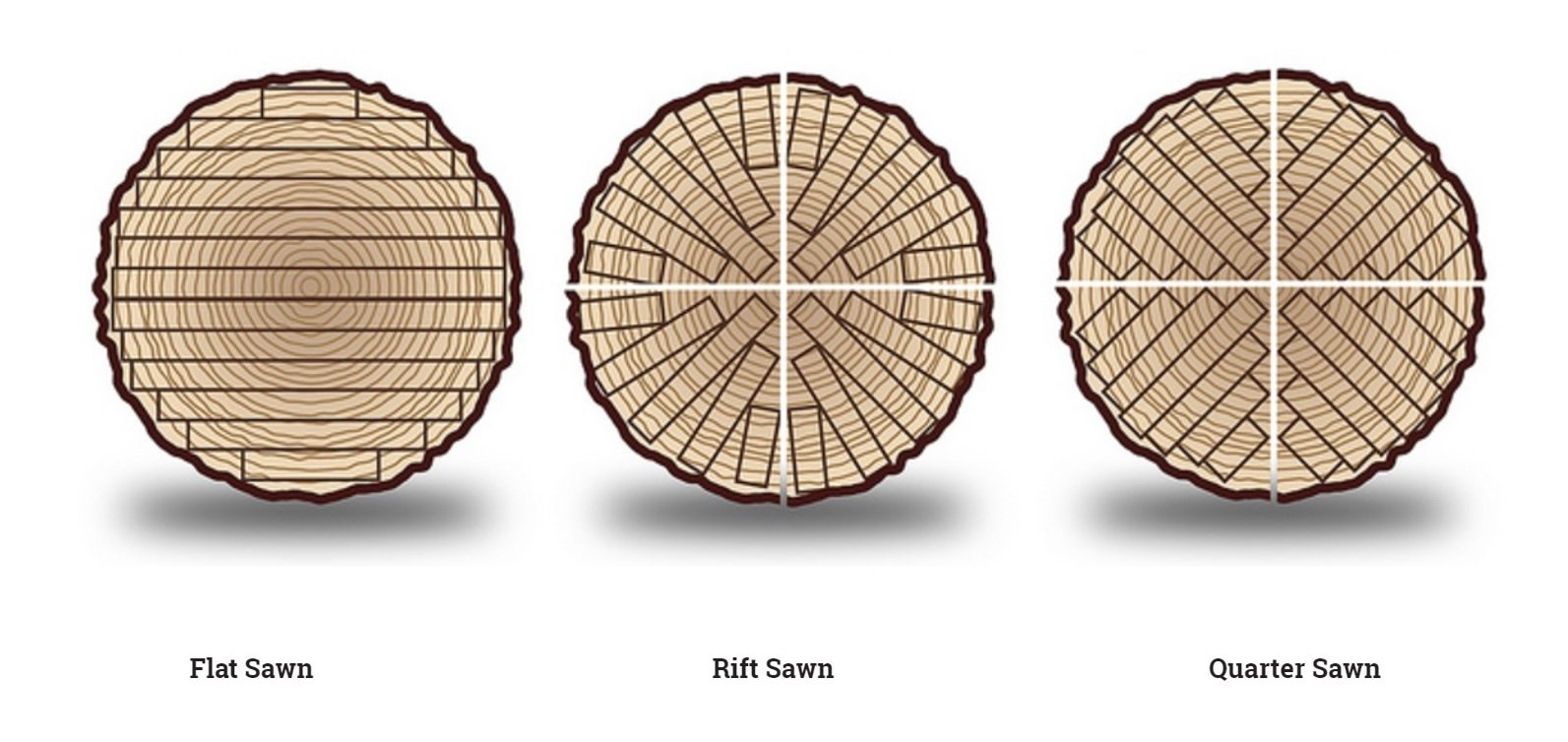

My little aside about the greater stability of narrow boards sure got some attention! Sorry, guys, I wasn't trying to poke a stick in the hornet's nest, just re-stating a "truism" I have heard many times over the years. I always believed it, and certainly know it to be true if the board you are beginning with has a pith line...that has got to go, which leaves you with two narrower boards. But is it a universal truth that wide panels are less stable? I guess I never really questioned it.
Looking into the question, I found that a quick search on line shows much disagreement on the subject. Most posters seem to feel that wider panels are more attractive and some claim they are more historically accurate as well. The "narrow is better" camp say that wide boards, varying from almost quarter-sawn at the edges to flat-sawn in the middle, are more difficult to retain flat. All boards tend to "cup" toward the bark side if unrestrained by joinery. Wider boards cup more. If the joinery restrains the cupping but does not allow for movement somehow, a crack results. A quote from a post to a FWW forum sums up the thinking of this camp: "The most stable boards have uniform growth ring geometry (pure quarter-sawn being the absolute ideal), and it's much easier to achieve uniformity with narrower boards. Hence, a wide glue-up of a number of boards will - all other things being equal - stay flatter than the same glue-up made from only 3 or 4 boards."
I think the idea of making panels from narrower boards likely started long before anyone from Shopsmith came up with it just to promote a product, and seems likely that it was an attempt to create panels with as much quarter sawn grain as possible.
The other team maintains, based on experience and the evidence of old furniture made with wide boards, that the narrow boards are not worth the time and extra effort. Carefully selected wide boards work fine as panels, per these folks, and look better to boot..
I think I will look into this some more. The truth might be that the answer to the question of whether or not use narrower boards is "it depends." Some species are inherently more stable in changing humidity conditions, and some wide boards can have a lot of vertical grain...these boards might work well as wide panels. But how many such "perfect" boards come through our shops?

Thanks. Yeah, I guess we should all expect there to be different opinions on this and I had to take a step back and think about it more. When I did my earlier post I thought about not just what type of saw method was used at the sawmill, but you also have to consider which board you actually get from that tree. Each one is going to have different movement vectors as it dries and acclimates. Not all boards from a tree are created equal! I won't talk about stress because that usually typifies something out of the ordinary for a given tree IMHO. Let's assume an ideal tree with boards that have minimal to no stress, but will move as moisture flows in & out of them. One key point, I think, is what are you building your projects out of it? I tend to build more "fine" furniture, etc. For the former, I only build in hardwoods while the latter are softwoods. Not too many panels needed for outdoor projects typically, so all of my panels have been hardwoods and interior use. My understanding is most/all softwoods are fast growing trees and my assumption is these are harvested early yielding small tree trunks. Hardwoods are slow growers by comparison and my assumption is these are harvested when they are large and can give a higher return with larger tree trunks. Assuming flat sawn and small tree trunk diameter on softwoods (much larger tree trunk on hardwoods), I would argue that cup-ability is higher on softwoods than on hardwoods. Intuitively, I can see how hardwoods having a much larger trunk diameter would yield many individual boards through flat sawing that approximate either a rift or quarter sawn cell structure. Said another way, I suspect cup-ability is higher on softwoods than on hardwoods. Not true of every single board extracted from the tree, but from a probability standpoint I believe hardwood boards are generally less susceptible to cupping than softwoods. Someone would have to do the math (geometric proof) on this to verify, but that is my theory.
I still say that IF one properly acclimates a board after near dimensioning (before final dimensioning) and then assembles the panel, there is a MUCH greater chance of NO cupping irrespective of whether it is a 3" or 6" wide board IMHO. I do believe many of the cupping issues reported in woodworking are less about the width of the board or internal stresses and more about rushing to finish a project and not giving the wood proper time to move. Also why you need to start with thicker lumber and plane/joint down to final dimension or else you will have a 1/4" thick board, but flat & straight board, to build with in the end. ;) IF you want a project to cup, go out and buy green lumber, cut it right away and assemble it immediately. :D
