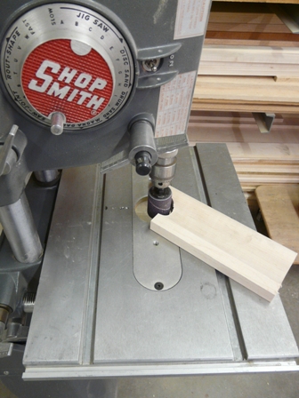

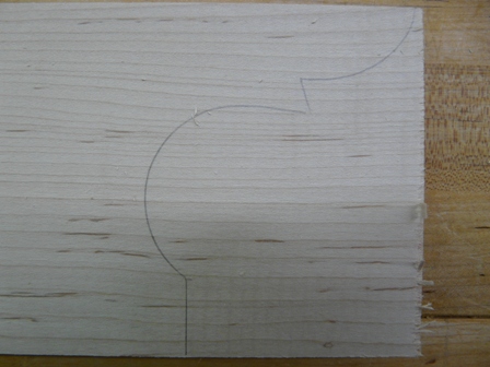

Making the feet
Post by mbcabinetmaker »

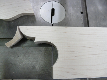

I have decided to wait to install the feet after installation. Unleveled floors can be a real pain.:mad: Here I have cut and sanded all parts on the Shopsmith equipment.
[ATTACH]4158[/ATTACH] [ATTACH]4159[/ATTACH]
[ATTACH]4160[/ATTACH] [ATTACH]4161[/ATTACH]
This new little stretched mini is fast becoming my favorite piece of equipment in the whole shop.:) :) :)
[ATTACH]4162[/ATTACH]
Mark

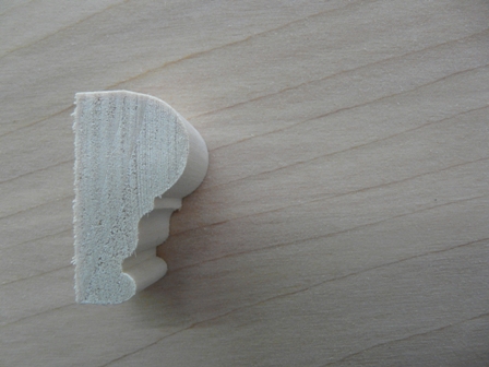

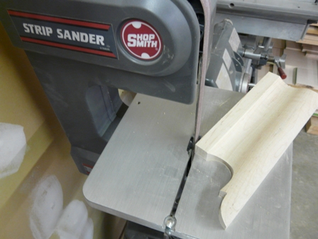

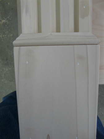

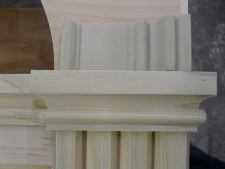

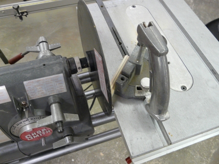

Here is one of the upper units being trimmed. Notice the plinth blocks on the bottom and trim around the top of the flutes. Here as on the bottom cabinets I used a solid block behind. Notice the small sample of RB3 Flex molding in the second picture. Those pieces have been ordered.
[ATTACH]4163[/ATTACH][ATTACH]4164[/ATTACH][ATTACH]4165[/ATTACH]

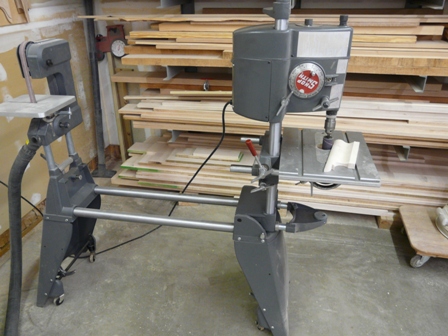

Always keep the Mark 5 set up with the sanding disc when running moldings.
[ATTACH]4166[/ATTACH]

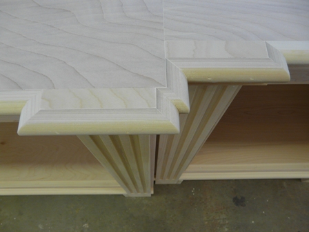

Making the top

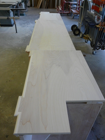

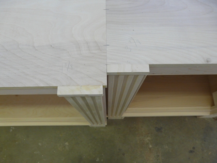

The top is made from 3 seperate pieces of plywood bicsuted together and wraped with a molding. I had to also step it out around the fluted pieces.

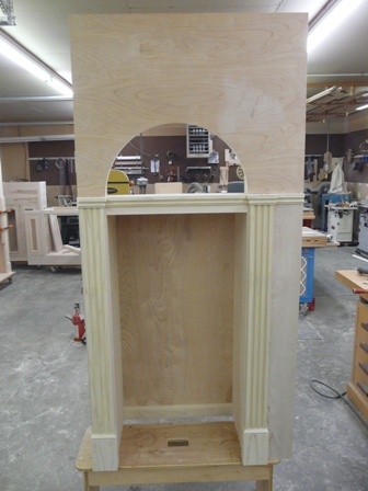

A little work on the headers

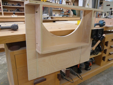

I don't thank I am going to like this 4 inch deep shelf in the archways. It is not large enough to put any thing really decorative.
[ATTACH]4173[/ATTACH]
