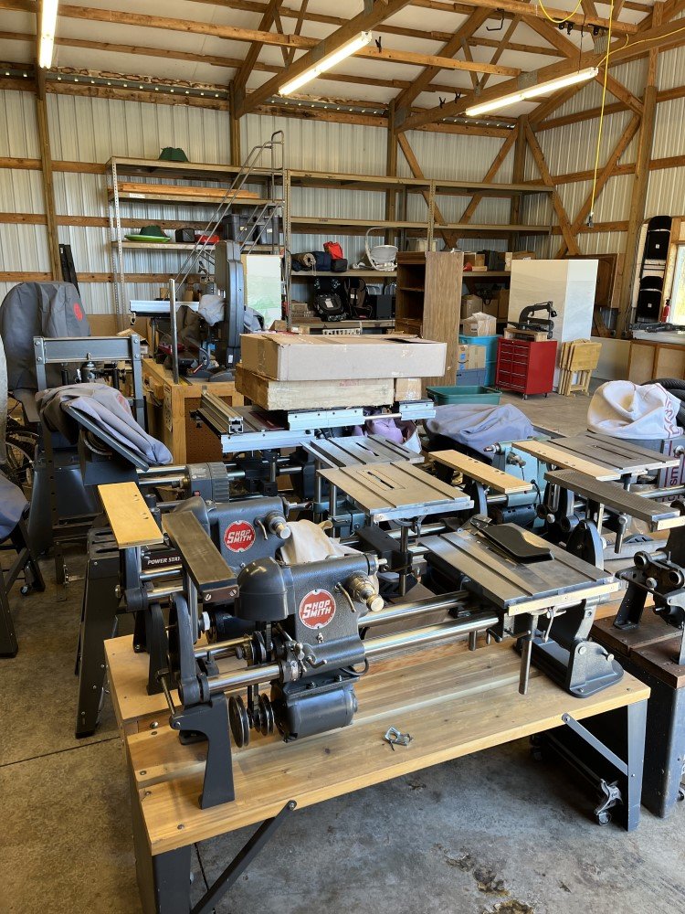

I know that to be true since I have done it and still enjoy restoring Shopsmith Tools. I have many waiting for their turn. I was going to list them, but it would be a long list. Below is moving day last year to the new (to me) shop at our new home. Can't even see all the Shopsmith stuff in the picture and more has been added since.

Seriously though it is great to see a new to Shopsmith person so excited about the Shopsmith Tools.
Re: New Member starting Restoration
Shop?
Looks like an airplane hanger!
:eek: WOW.
I don't think a warning would have helped any. :D
Dwayne
