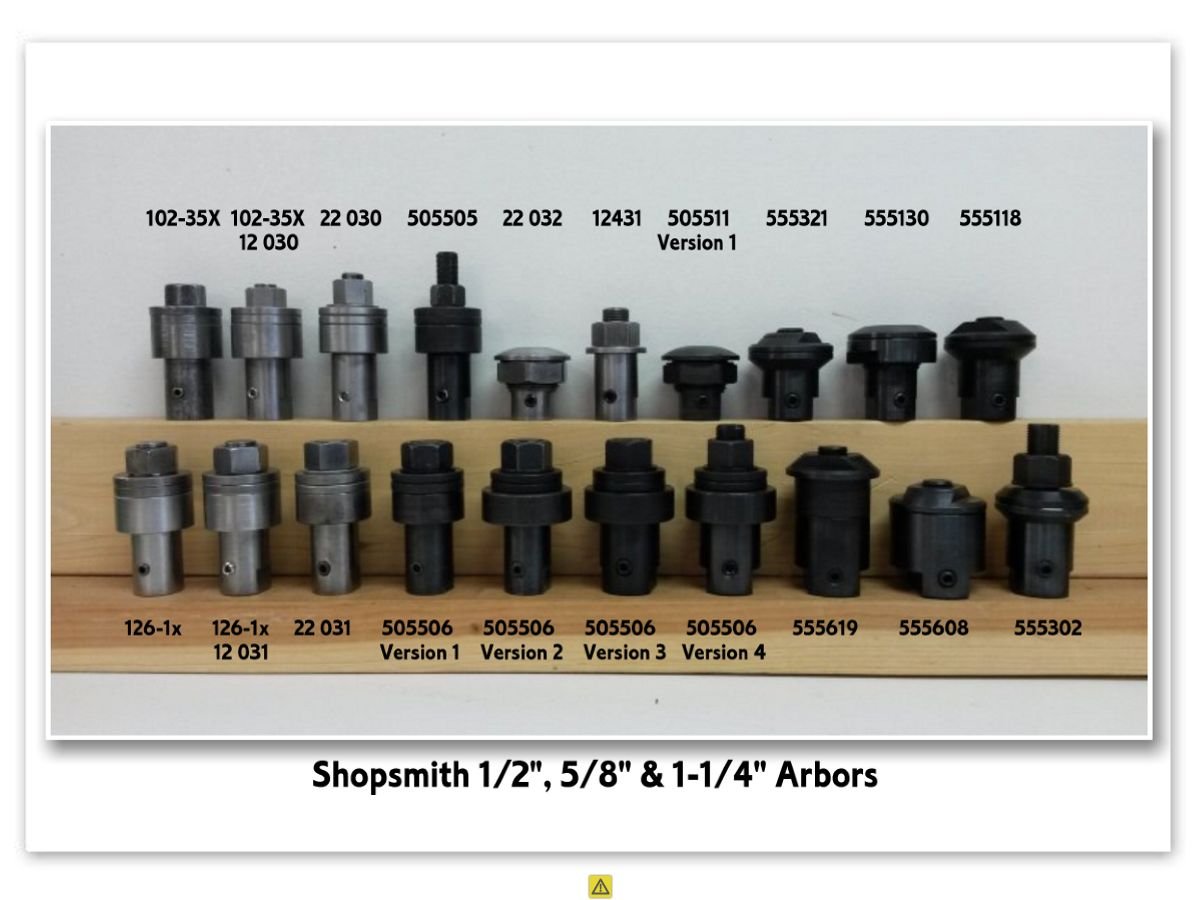

Even with around 150,000 Shopsmith Model 10's originally sold it would not be cost effective for a company to still be making replacement parts and accessories for 70 plus year old tools. The Table Riser Arm does come up for sale from time to time at online auction sites like eBay. One thing that does help is expendable items like the 3" Sanding Drum Sleeves and 12" paper for the Sanding Disk are the same size as the first ones made for the Model 10E. The Quill's Spindle has always been a 5/8" diameter reverse taper so most new accessories that attach to the Spindle can be used. As an example, I can take the Lathe Drive that came originally with my oldest Model 10E (S/N 1033) and use it on my Mark 7 and vice versa. Some current Arbors should not be used on a Model 10.
The Model 10's had 2 basic Arbors, the 5/8" and the 1/2" which were universal Arbors used for the 8" saw blades, Dado stack blades, grinding wheel, etc. It is the reason they have a machined wide spacer and two thick machined washers. The spacer and a washer are used for thin items like a saw blade and the two washers are used for wide items like a grinding wheel. The machined side of the Spacer and Washers face the item mounted on the Arbor. The current version of the 5/8" Arbor is now called the Molder/Dado Arbor. The 1/2 Arbor is now sold as the Shaper Arbor with the shaper collars instead of the spacer and 2 washers. There was a separate Shaper Spindle in the past.
The picture below shows a lot of the Arbors made over the years. The first two from the left on each row are the Arbors made for the Model 10's. The third on each row is the Arbors made for the Mark 5 beginning in 1954 and into the early 1960's. The top row is 1/2" and 1-1/4" Arbors and the bottom row is 5/8" Arbors.
_
- Arbors Labeled - inc.jpg (101.71 KiB) Viewed 7019 times
This is the best picture I have for those early arbors all together. Most of those other Arbors can be used on a Model 10E or 10ER.
As for the 0.015 play in the Spindle that may be corrected, as JPG suggested, by replacing the two bearings. I would also consider replacing the two Drive Sleeve Bearings. It is possible, but not as likely, that the Spindle is bent. One of my Model 10 restorations had a bent Spindle which I replaced. Its runout was much worse.
The 3L-370 belt is skinnier than the 4L-380 normally used and would sit lower in the pulley grooves. It may slip more than the normal 4L-380 belt.
