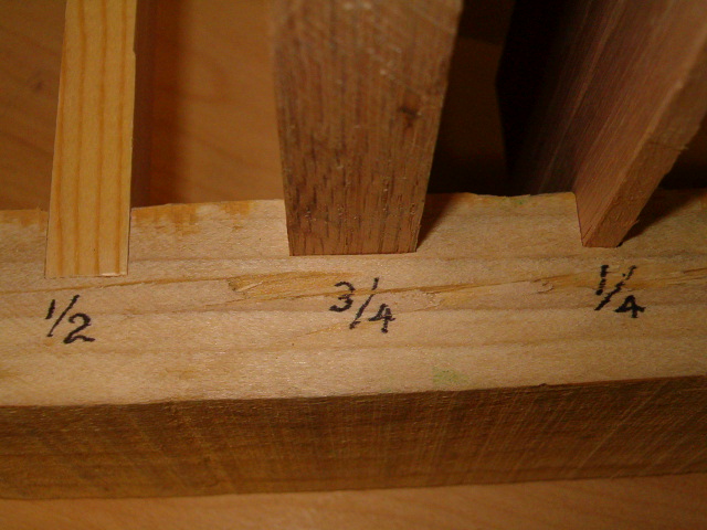

So I went to the shop again, camera and caliper in hand to see what kind of inaccuracy these three dados would present.
Measured depth of one shoulder of the 1/2" dado was 0.481" - the other shoulder measured 0.478". a difference of .003".
Question - is this significant? so found some 1/2" scrap, some 3/4" scrap and some 1/4" scrap and shoved them into the respective dados. Here's what they looked like -
[ATTACH]4636[/ATTACH]
As I had suspected the .003" slope didn't matter at all.
The photo is a little funky. I did not notice that little defect in the 1/2" piece of wood until I saw it in the photo.
The 1/2" pine sits a little proud of the dadoed piece and the shiny spot we see is a dent in the end corner of the pine. A real close look will show a small hairline opening near the right bottom of the 1/2" dado. Also the lower right hand corner of the 1/4" dado should show a small gap right at that corner. (The depth difference there is 0.0015" corner to corner.) But someone would have to inspect these dados individually to find the hairline openings.
The point of all this exercise is to point out that even some wobble dado blades work well enough for the great majority of woodwork. At many times the cost of a wobble, I personally can't justify a stacked beauty. Maybe wobbles just aren't suitable for many woodworkers, but if one is a bit strapped for cash, --- wobbles work good enough.

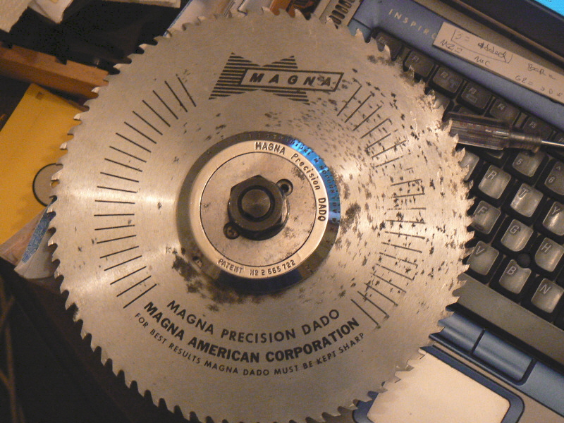

[ATTACH]4642[/ATTACH]
This is the culprit! 1960's example of SS's 'finest'.

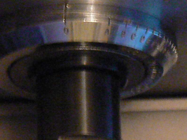

[ATTACH]4643[/ATTACH]
This shows the adjustment scale on the wedge shaped washers. An identical pair is on the back side. At the position shown, the blade does not wobble, and produces a 5/32" groove. The scale runs through the alphabet from A to Z. These washers are adjusted with a 1/8" SQUARE key inserted into a gear which causes the washers to rotate relative to each other thus changing the 'wobble'. Focus is terrible, Sorry!

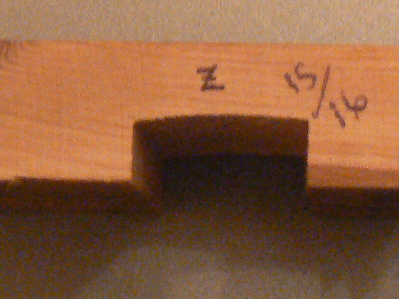

[ATTACH]4644[/ATTACH]
Here is the result obtained with the washers set to the MAXIMUM setting "Z". It produces a 15/16" wide groove, with a noticeable 'round bottom'. It also has a difference in depth of about 1/32". It is this difference in the depth at the sides that created my displeasure. The curved bottom is not so much the problem as the difference in the side depths. A board inserted into the cut would NOT set firmly at a square angle since the side depths were different.

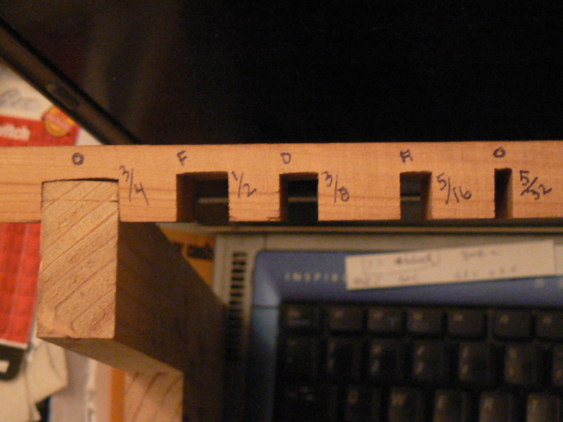

[ATTACH]4645[/ATTACH]
This shows the results obtained at various settings of the blade. ALL have the lopsided depth problem. Closer examination of the blade revealed the source of the problem. The outer edge of the blade varies by >>>1/32"<<<! The blade is NOT round!!! This is a serious defect IMHO!
Final conclusion(s): My disdain of wobble blades was based on my limited experience with ONE DEFECTIVE blade. I am delighted to have discovered that better results ARE obtained with a PROPERLY ground/sharpened blade. The inconsistent radius of MY blade was the ORIGINAL sharpening done when originally manufactured. It would appear that its problem CAN be fixed by PROPER sharpening. That is NOT something I WILL do. TOO many teeth, and I have a chipper dado blade now.

Looking at the photo of JPG's Magna blade it became quite clear to me that my wobble is not a Magna. Mine has only 16 teeth and looks exactly like the picture of the "Vermont American" wobble dado referenced earlier in post #19 - - - http://www.amazon.com/Vermont-American- ... 83&sr=8-17 (Although the picture on that thread shows 24 teeth, the text says 16 teeth.)
The Magna blade shown has steel teeth that all appear to have the same set (swedge). Since the blade is not perfectly circular, it's my guess the portions of the circumference that tilt the farthest have a larger radius so they will form a flatter bottom to the dado. Guess that didn't work too well.
The blade I have has carbide tipped teeth that are filed with varying tips according to their placement. If you look at the 1st and 2nd photos in post #29 you will see black marks below the carbide on the out part of the wobble. (This was caused when I had the blade set at 1/4" diam. inside the regular sawblade insert - and missed the center.) (Note that on one side of the blade the marks are on the opposite side of the circumference from the marks on the other side)
The tooth in the center of those marks sticks out the farthest in a dado. It's tip is filed with more inward slope than the others. The slope becomes less as until there is a flat tooth and then, on the next couple teeth, the slope changes to be high toward the opposite side of the blade.
