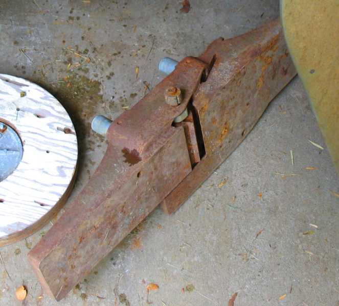

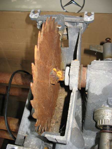

[ATTACH]5517[/ATTACH]
[ATTACH]5518[/ATTACH]
rstl99 wrote:Thanks JPG, wise advice. I only ordered one gallon of the stuff (and up here in Canada, it's $30/gal! :( )
Does that 1" closed en piece for the center tend to want to float out when pouring the stuff in?
I'll remember to measure the bench tube length for cutting the pipes.
Look forward to seeing what Evaporust will do for my saw blade and jointer!!!
The 1" pipe WILL try to float out, but is easy to hold in. Allow an inch or two extra length. If making a set(2) just cut the 2" in half(10 ft/2). Cut the 1" so it will fit into the 2" after both(2" and 1") have the end caps attached. Remember only one end of the 2" need to be an access plug. All others can be capped. The extra length will not require extra evapo-rust since you only have to pour enough in to just submerge them. Have a large open top container to empty the tubes into. That tiny hole in the jug the evapo-rust came in is difficult to 'hit' while balancing all the above WITH a tube inside! Be prepared for the tube to slide out when the pipe is emptied. The evapo-rust is 'stickey'(think very thin honey). Do not be concerned with flushing out the inside of the tube. The evapo-rust will act like a rust-preventative. The outside may either be flushed(washed) off or just let the polishing operation take it off.(you ARE going to polish them?)

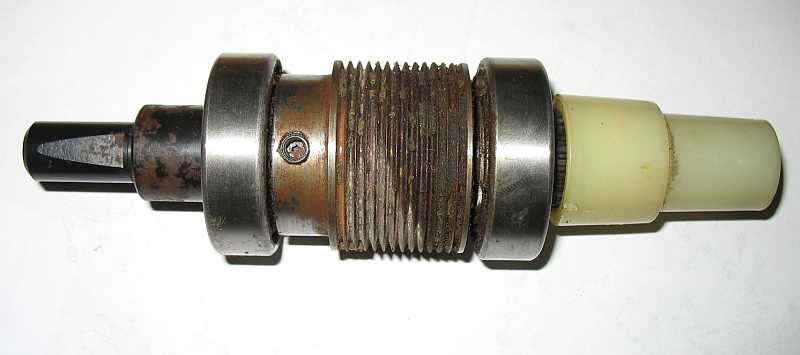

I have found a canadian supplier of SS parts, who have a "drive sleeve assembly" (part no. 518145) still in stock. Based on the diagram, I believe this is the part I took out of my drivetrain andwhich has a faulty bearing. I figure it's easier to just get a new unit, since I'm not equipped (tool and knowhow wise) to attempt a bearing replacement.
In watching the sawdust session, he refers to this part (see picture of mine) as the "drive shaft". Is that synonymous with "drive sleeve assembly"? If not, please correct me, as I would hate to order the wrong part!
Thanks.
[ATTACH]5522[/ATTACH]
rstl99 wrote:I have found a canadian supplier of SS parts, who have a "drive sleeve assembly" (part no. 518145) still in stock. Based on the diagram, I believe this is the part I took out of my drivetrain andwhich has a faulty bearing. I figure it's easier to just get a new unit, since I'm not equipped (tool and knowhow wise) to attempt a bearing replacement.
Thanks.
518145 IS what you pictured, but without the white plastic(nylon?) quill splined shaft coupler.
