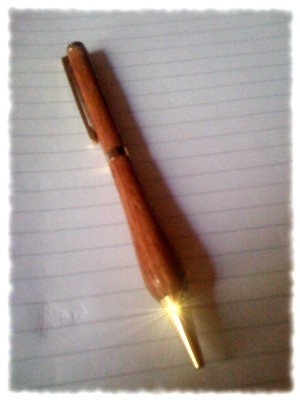

finally got the penn state starter kit, this is pen #3...
[ATTACH]5965[/ATTACH]
I've already blown out 2 blanks, one on the lathe probably because my gouge wasn't sharp enough, and one while squaring the end, the reamer kindof caught the grain and ripped off a chunk.
Great new hobby!
Great new hobby!

JC, nice looking pen. What wood did you use on that? Two of my favorites have been Cocobolo and Olivewood, although I am quickly starting to like Box Elder Burl wood for it's great grain too.
I had a couple blow outs when I first started, but have not had a problem lately. One thing I've started doing different is making sure the brass tube is roughed up with sandpaper first, and using PLENTY of CA glue (thick). Looking at my first blow-outs, there were voids in the surface where there was no glue.
Another thing I found out, if you place the tubes from the blown-out pens in a small jar with a little acetone in it, and wait about 24-36 hours, the tubes will just fall out of the remaining wood blank and you can reuse them.

I used just the rosewood blanks that came with the PSI starter kit. Have you turned anything open grain? I have some white oak I want to try but I'm not sure how best to fill the grain.tom_k/mo wrote:JC, nice looking pen. What wood did you use on that? Two of my favorites have been Cocobolo and Olivewood, although I am quickly starting to like Box Elder Burl wood for it's great grain too.
Awesome suggestions!tom_k/mo wrote:I had a couple blow outs when I first started, but have not had a problem lately. One thing I've started doing different is making sure the brass tube is roughed up with sandpaper first, and using PLENTY of CA glue (thick). Looking at my first blow-outs, there were voids in the surface where there was no glue.

Cool - thanx!paul269 wrote:When I have a wood blank blow out I just remove the wood while attached to the lathe. I use a parting tool to work the wood down to the brass tube and remove the dry CA glue. Quicker that soaking in Acetone.
