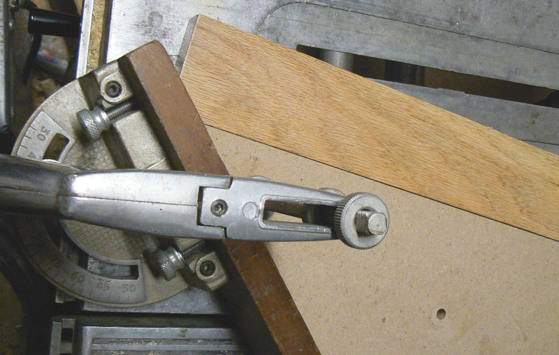

[ATTACH]6000[/ATTACH]
The oak is the 'workpiece'.
The MDF is the 'adapter'.
The miter gauge is set to 64º.
The workpiece is 19º from the blade(blade not shown).
