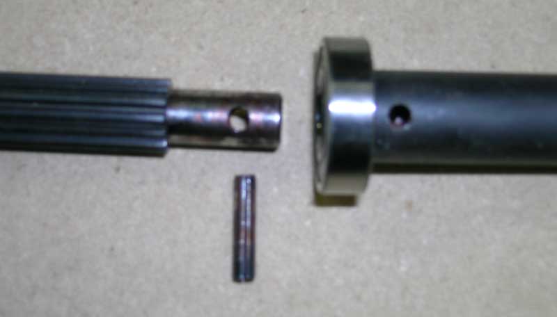

Though I have already mounted the two bearings on the spindle I will try to dismantle it again and take some photographs to post here. I am not using it because of the vibrations I encountered once it was reassembled without play.
So while I wait for the replacement I will become photographer and mechanic. Please bear with me folks.

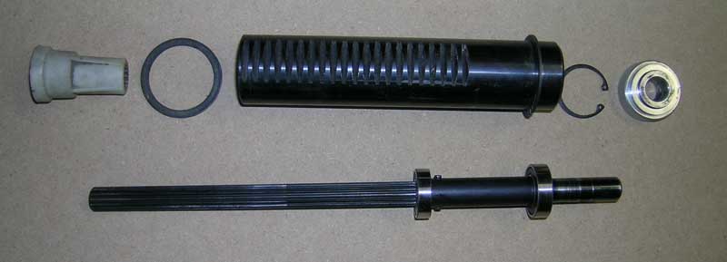

OK. So we can all see what we are talking about I disassembled the quill again and took some snapshots.
Quill-01 shows the quill disassembled into its main components.
Quill-02 shows the quill completely disassembled and you can see the elastic pin I am talking about and how the spline end separates from the spindle end.
Quill-03 shows a close-up of the separation and the different parts. You can see here why the spinde must be disassembled to take off the small bearing.
Hope this helps everyone to see the problem. When there is play in the pin (you can see some rust still on the insert due to condensation I imagine) this adds to any play the spindle might have on the driver/spline end. This was what produced the excessive lag I experienced.
