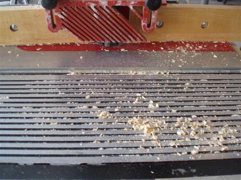

dusty wrote:I've been thinking about this situation and have decided that I do not know how to set up the shapers (because I have not done that since I had my accident). So, I went to the shop first thing this morning to do a more realistic setup.
After installing the cutters, adjusting the table so that the cutters sit safely in the insert and adjusting the fence for proper depth of cut (I setup for maximum cut depth), I have decided that the "quill mounted featherboard" CANNOT be used in conjunction with the miter fence for reasons already shown.
The following is a possible approach to resolve the original problem.
[ATTACH]7035[/ATTACH]
The tablle and the fence can be moved a little to fine tune these setups but care must be taken so that the cutters and the insert do not simultaneously attempt to occupy the same space.

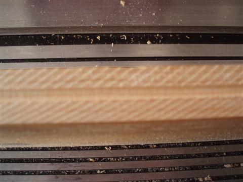

You two, et al, have brought me back a Christmas gift that I have had for many, many years. I now have a new tool to use in my shop. I now have a shaper.
I have not tooled up the shaper in over a dozen years due to an accident that I had while using the shaper. I nearly lost a finger (with damage to a second) due to this past incident. To this day, I am unable to tell anyone exactly what happened - I don't know. I don't believe the cutter got me but I don't see how a "kickout" could have done it either.
Today, in order to better understand this thread, I tooled that puppy up and made a few "shaper chips".
[ATTACH]7036[/ATTACH] [ATTACH]7037[/ATTACH]
The results are nothing to brag on except that they exist. Now that I have come this far - I will make more shaper chips and I will learn why this cut has so many cutter marks.
NO, I did not have the dust collector connected.

BTW Your shaped workpiece has me puzzled also. What surface/shape are we looking at?

I don't know what I have mounted without going out to look but what has you confused (I believe) is that I have taken a very shallow cut. Only the very tips are touching the work piece.
I have NOT been using my shaper. I have avoided using it for many years. Doing this shallow cut, along with this thread, marks my coming out.
I think.
One thing that happened, during this test cut, was a movement of the quill. I need to check that out before I do anything more. The quill does not seem to be adequately secured even if I crank down on the quill lock.

It is those diagonal ridges that have me confused. If they are not part of the shaper formed surface, they are irrelevant.
