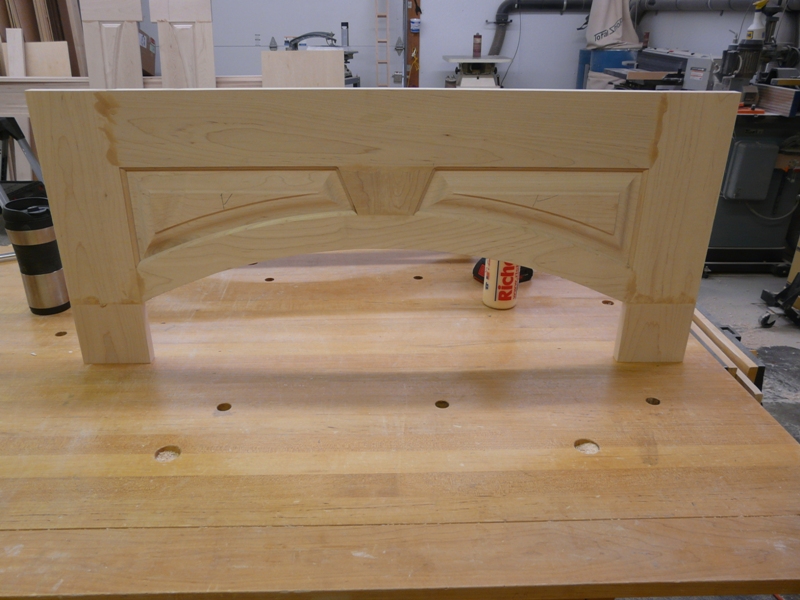

[attach]7851[/attach]

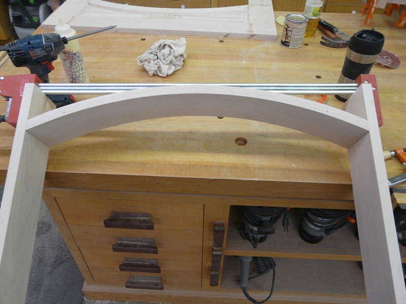

This is our header assembled and in the clamps.

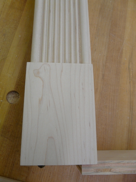

[attach]7852[/attach]
I have cut and sanded the bottom radius and attached two 4 inch plinth blocks with pocket screws on the back side.

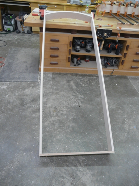

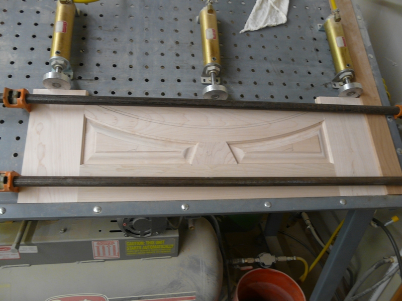

[ATTACH]7849[/ATTACH]
Remember this curved jamb that we started the project with. I have cut it down to 4 5/8 in width and 32 inches in length and attached it to the other jamb members.
[ATTACH]7850[/ATTACH]
It is hard to get a picture of this at 82 inches long. The bottom member in the photo is just a temporary brace screwed to the bottom

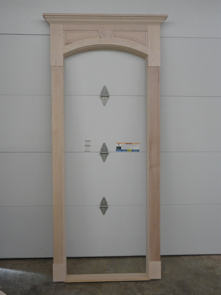

[attach]7858[/attach]

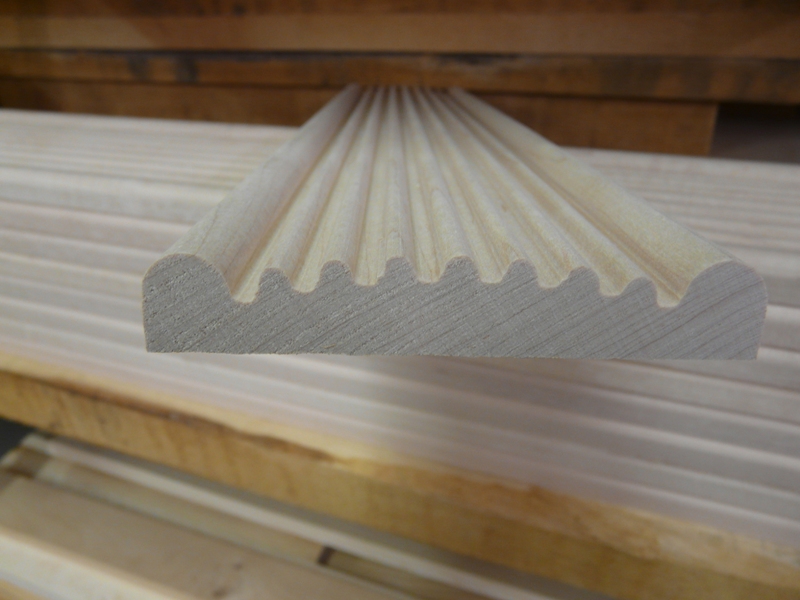

Now all we have to do is attach everything to the frame. This is the profile of the casing.
[attach]7859[/attach]
The bottom gets a 6 inch plinth block.

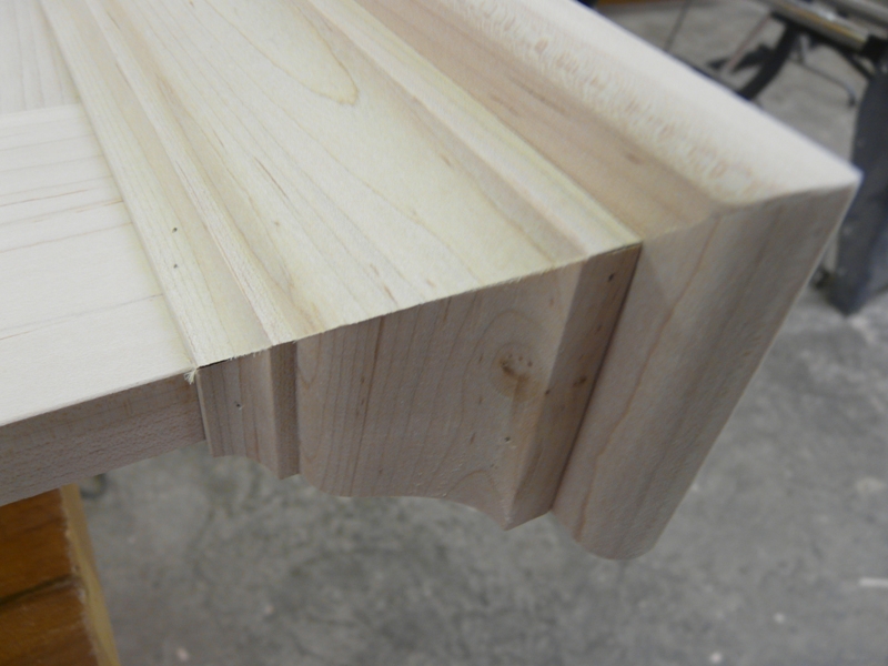

[attach]7860[/attach]
The top of the panels get a 2 1/2 inch crown molding with a 3/4 inch bull nose top cap.

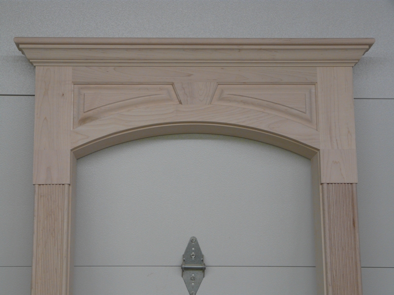

[attach]7861[/attach]
Every thing looks better after final sanding.
[attach]7862[/attach]
This is our cased opening finished on one side. The back side is a mirror image but will be installed buy the builder at installation.
