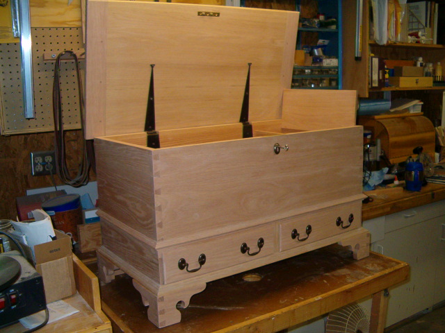

Here are a few photos of the blanket chest ready for applying a finish. All parts are installed and much of the sanding has been done.
The lid of the till box holds the lid of the chest up. There is no need for a chain nor spring loaded hinges. These hinges came from "Nathan's Forge"

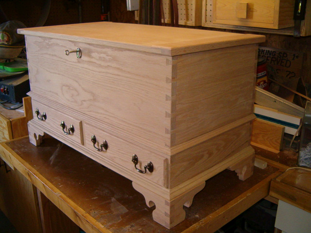

closed chest - the drawer pulls and escutcheons came from "Horton Brasses"

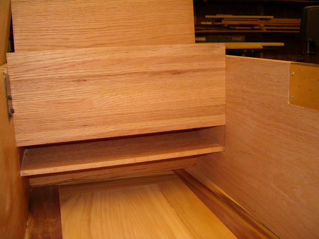

Side of till box raised to show false (hidden) bottom Also showing the back of the mortised lock which still has steel screws holding it. Brass screws will come later.

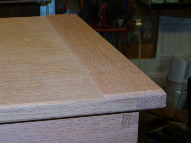

One of the breadboard ends. It is proud 1/16th inch from the top - done so to hide any future gaps possible caused by wood movement.

Really nice work, Charlese.

Chuck:
As usual, your craftsmanship is outstanding. Well Done!

VERY NICE! Your work is very good.

GREAT looking blanket chest there Chuck.

Looks GREAT. Can I order 23 of them from you?? :D

GREAT Job, Chuck!
By the way, would you have built a larger chest if your assembly table was larger?:o
