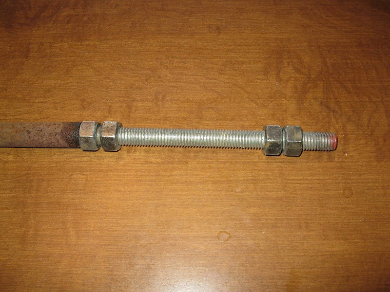

Here is a picture of the simple screw-jack concept using iron pipe and All-thread rod.
[ATTACH]7942[/ATTACH]
This is not the piece of All-thread rod I expect to use, it was just a piece of 5/8ths inch I had in a bin of shorts. The pipe is a piece of 1/2" black pipe and is what I will use.
Now I need to explain here that 1/2" pipe is NOT 1/2"... It was 1/2" many years ago but with improving technology the pipe is now thinner walled. Since it is necessary to keep the outside diameter the same for threading etc. reasons the bore is now a lot bigger than 1/2 inch.
If they changed the O.D. it would also mess up all of those pipe based bar clamps.
The idea is to keep it as simple as possible. There are several possible ways to mount the bottom (the bottom is the end at the right of the picture). The simplest is to just have a loose 5/8ths hole as a socket and lock the two nuts at that end together with a stub sticking out far enough to sit in the hole.
The two nuts at the other end will each have a small lever welded to each one so that they can be locked together tight enough to stay put by hand instead of bothering with wrenches. They do not have to be tightened like you are locking Godzilla's cage, just enough to keep them from vibrating out of position. The upper end of the jack also has a lot of different possibilities depending on which table it will support I have not worked out the lengths needed for the two parts yet. The All-thread should still be at least 2" up in the pipe when fully extended. I'll have to just play with it a little to get the dimensions. The cost is low enough to make several sizes.
