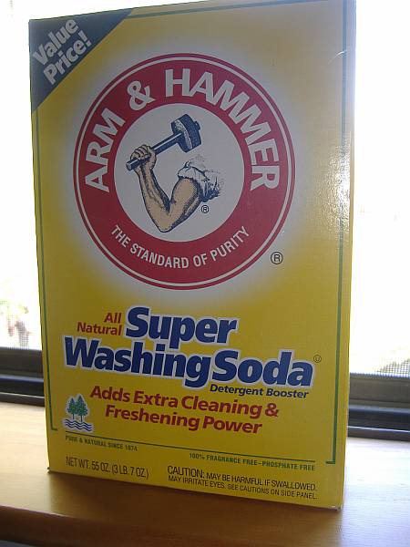

JPG40504 wrote:My 'washing soda' has a caution on the side of the box that says 'CAUTION contains sodium carbonate . . .
Does yours have a similar warning? If so, what says it!
BTW It resembles simmering rather than 'boiling'. Once the precipitate starts floating on the electrolyte, you will have no doubt something is happening!
Do not expect to see shiney metal. It will be dull black oxide with darker splotches where pitting was.
There is a foam collecting on top that is flecked with what could be loose rust particles (based on appearance). It seems to be working.
The laundry soda box does contain a warning. It reads:
CAUTION: Contains anionic and non-anionic surfactants, sodium carbonate and enzymes.

Reference box of what I use:
[ATTACH]8615[/ATTACH]
Questions?
