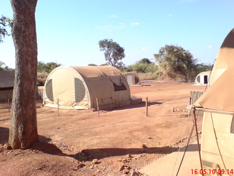

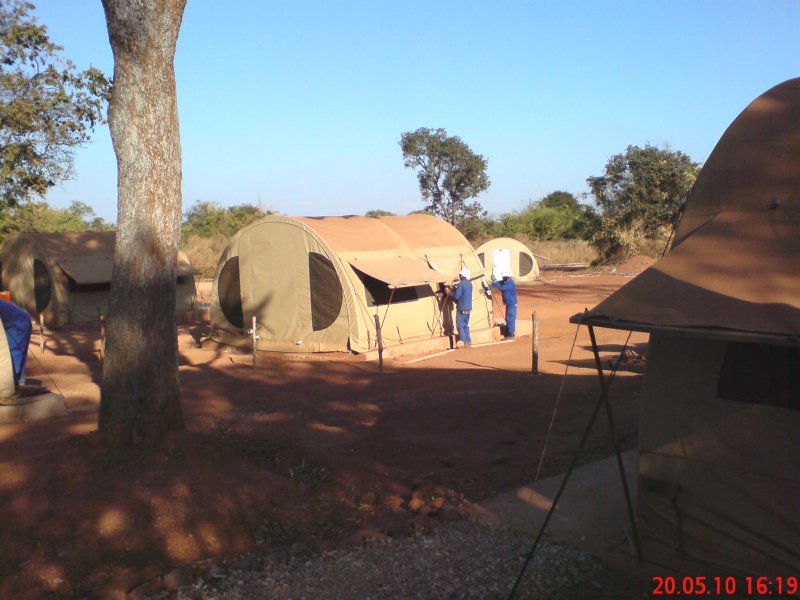

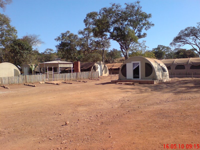

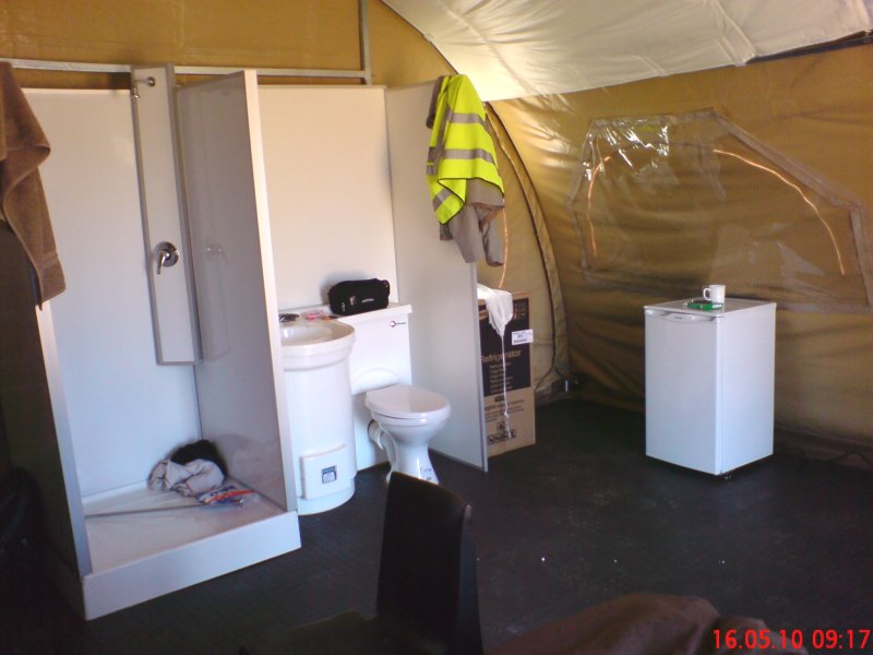

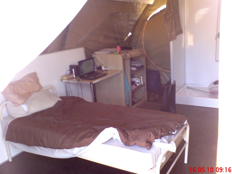

Got an email from PG-ZAC showing his new 20. He's got his own private suite vs. others bunking up 2 to 4 per 'room'. Here's some pics.
