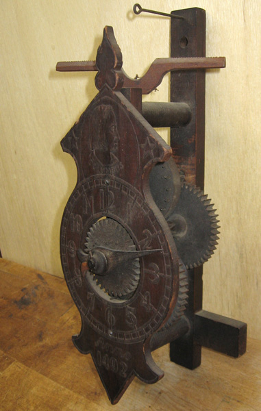

Paul,
These clocks are all loosely based on the design used for the "Columbus Clock" these clocks were sold during the Columbian Exposition in Chicago and for a number of years following. This clock was also reproduced in the 1970's.
[ATTACH]9044[/ATTACH]
Over the years there have been many variations all based on this design. I have one and to my shame passed on an impressive 3 foot tall version.
They are novelty clocks that bear only a passing resemblance to the 15th century iron clocks they are said to copy. Great fun but terrible time keepers. The verge and foilio is inherently an innacurate escapement and you are quite right to be suspicious of any claims in accuracy.
Troy
