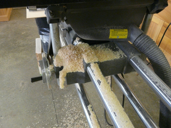

I was cutting some 1/4" tenons using multiple passes with the regular sawblade today. When I finished, there was something I virtually never see on both the upper tubes--a lot of fine dust. (I hope it's not because today was the first time I installed the metal covers for the Lower Saw Guard knob holes!) When I looked up under the table at the tie bar guard, there was a big pattern of the same dust at the upper forward end of the tie bar guard. From the top of the guard, the dust pattern worked downward toward the carriage (which was covered in dust), and back along the top edge of the guard for about 3 inches. The remainder of the guard showed only a very small amount of dust. So a good bit of escaping material seems to be coming over the tie bar guard.
I see that Dusty's new deflector/reflector insert covers up the area I am talking about. But I thought I would pass on what I saw, since up to now no one has definitively identified the slot above the tie bar guard as a source of dust.
Jupiter, FL
tryinhard wrote:I was cutting some 1/4" tenons using multiple passes with the regular sawblade today. When I finished, there was something I virtually never see on both the upper tubes--a lot of fine dust. (I hope it's not because today was the first time I installed the metal covers for the Lower Saw Guard knob holes!) When I looked up under the table at the tie bar guard, there was a big pattern of the same dust at the upper forward end of the tie bar guard. From the top of the guard, the dust pattern worked downward toward the carriage (which was covered in dust), and back along the top edge of the guard for about 3 inches. The remainder of the guard showed only a very small amount of dust. So a good bit of escaping material seems to be coming over the tie bar guard.

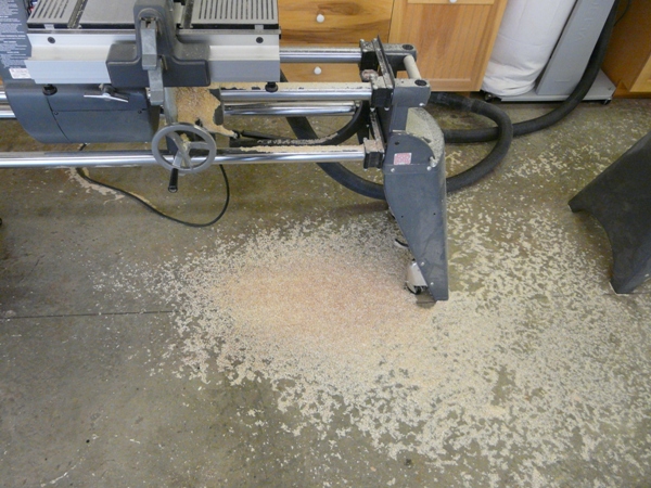

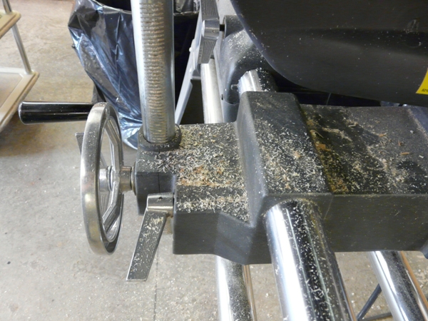

I just completed the dado's on 9 drawers and thought I would post the before and after pictures of the modification that I did a couple of weeks ago. The original mess was after just 4 small drawers.
[ATTACH]9623[/ATTACH]
[ATTACH]9619[/ATTACH]
Before baffle
[ATTACH]9620[/ATTACH]
After baffle
[ATTACH]9621[/ATTACH]
Before baffle
[ATTACH]9622[/ATTACH]
After baffle
For a simple little baffle to make this much difference well it just Baffles me.
