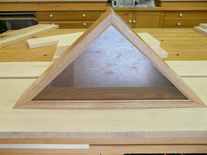

mbcabinetmaker
Posts: 1627
Location: Greer SC
Post by mbcabinetmaker »
Proto type passed inspection.
[ATTACH]10276[/ATTACH]
[ATTACH]10277[/ATTACH]
Now all I have to do is build the other 15.
Mark

Prototype looks great, but...
Post by tryinhard »
I don't see it with a folded flag installed. If you tweaked the triangle too much, it won't conform. And even though a flag "is not an immovably firm substance" like JPG says, having a box that puts pressure on the tightly folded item will make it look "wrinkled," or leave it with gaps on the sides.
Oh, and be sure to get a fold where the stars look like a setup of bowling pins.

mbcabinetmaker wrote:Proto type passed inspection.
At what degrees did you end up cutting the angles?
