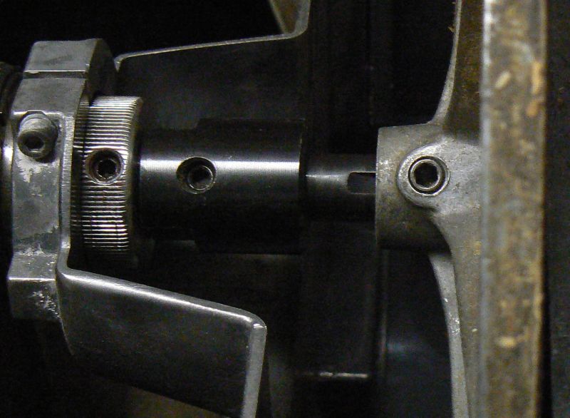

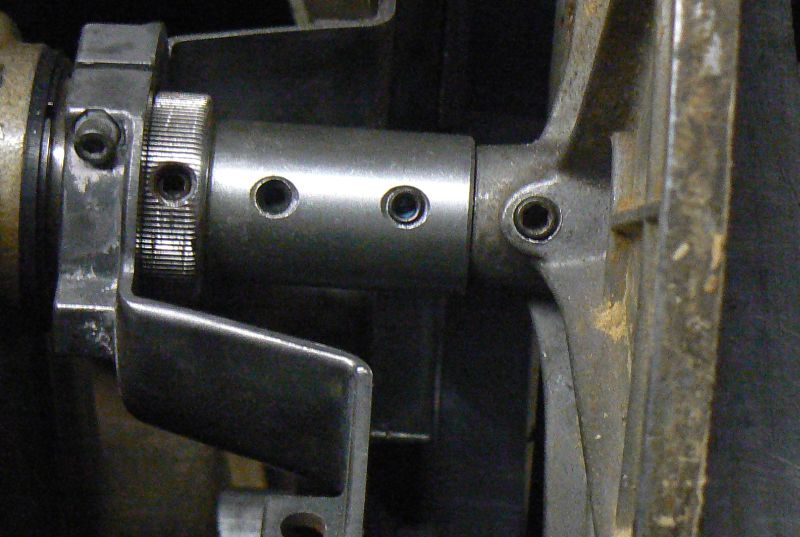

[ATTACH]10461[/ATTACH]
[ATTACH]10462[/ATTACH]
BTW The disk IS from a Model 10!
sand disc dc adapt1.jpg (94.02 KiB) Viewed 2840 times
sand disc dc adapt2.jpg (93.79 KiB) Viewed 2834 times
