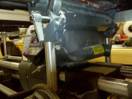

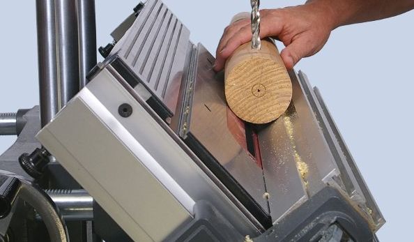

More specifically, https://forum.shopsmith.com/viewtopic.php?p=75219&postcount=31
Not shown in his pix is the gear rack on both sides of the table support tubes.
They are there and can be seen in the pix on the ss site that shows the Mark 7 in drill press mode(the rack faces away from the pinion gear(up).
[ATTACH]11054[/ATTACH] [ATTACH]11055[/ATTACH]
Notice in his 4th pix, the teeth are on the other side of the tube, hence they be on both sides!
m7 table tube.jpg (28.19 KiB) Viewed 4474 times
