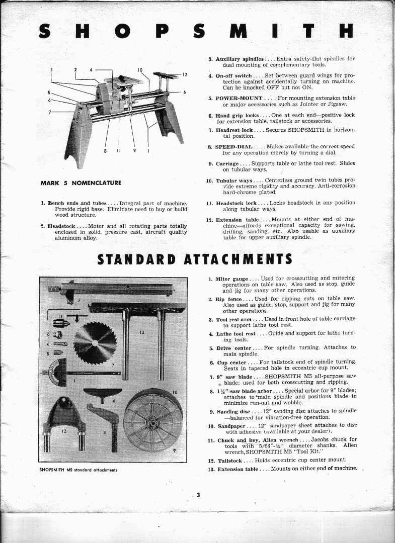

Thank you JPG. I'm still trying to get my sea legs here; there's a lot to learn. Would you be so kind to let me know where I can find the original 1955 Mark V packing list? I'd like to know if I'm missing anything. I downloaded the MKVSTDPartsList _1_14.pdf but it appears to be for a later model.

DMcCam wrote:Thank you JPG. I'm still trying to get my sea legs here; there's a lot to learn. Would you be so kind to let me know where I can find the original 1955 Mark V packing list? I'd like to know if I'm missing anything. I downloaded the MKVSTDPartsList _1_14.pdf but it appears to be for a later model.
Thank you again,
Dave

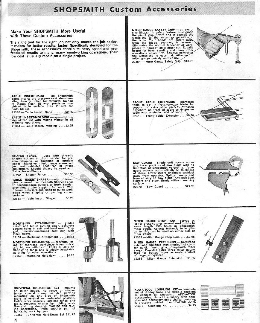

I do not have such a list, but can show you what came with my 1963 Goldie.
Goldie standard accessories 1963.jpg (561.98 KiB) Viewed 55865 times
Should be visible after Admin kills the bug again.

Wow, Thanks JPG!
I can't see from the image, did the table come with a saw guard? If not, it looks like I've got the lot including the casters and a few more saw blades!

DMcCam wrote:Wow, Thanks JPG!
Dave
No. It was an 'extra cost' accessory.
goldie optional accessories p4.jpg (693.72 KiB) Viewed 55837 times

I guess so! Back in the day it would have been like spending $200 today.
In reviewing the list, I've got the Table Insert Dado, Add-A-Coupler, Front Table Extension and Miter Gauge Safety Grip. I also have the Jointer. If everything cleans up OK, I'll have a good start.
