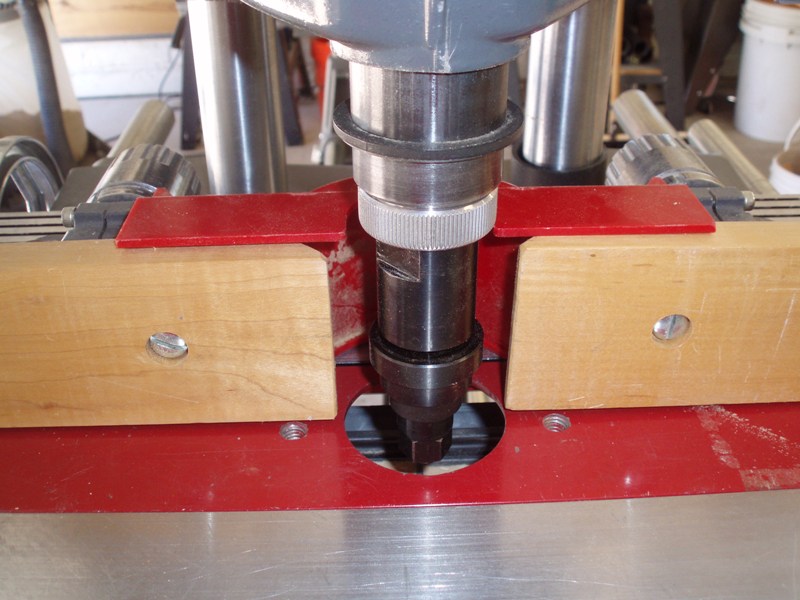

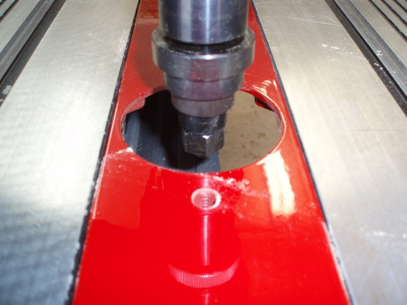

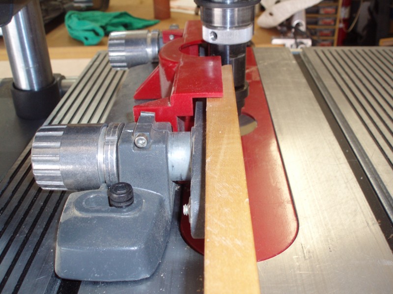

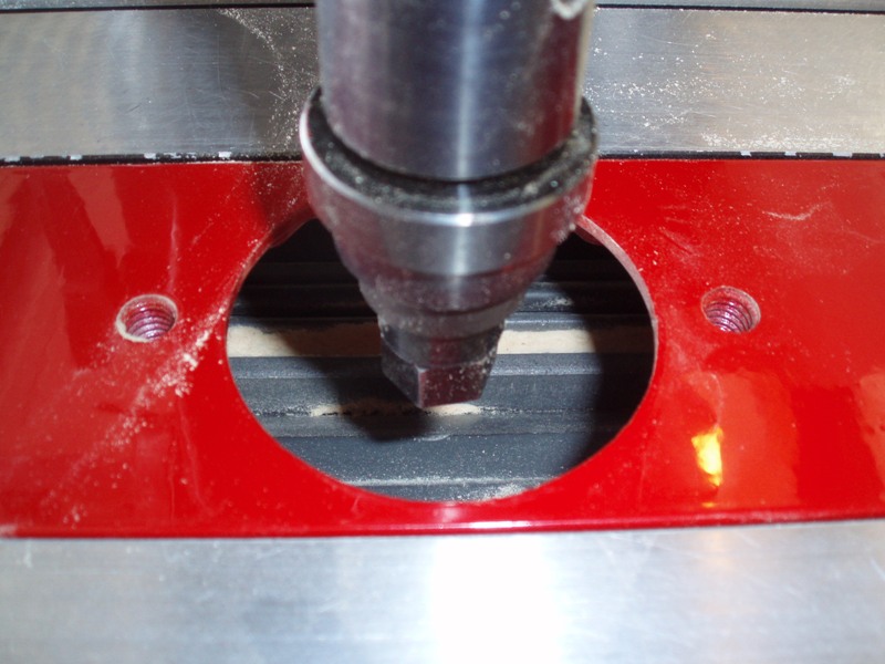

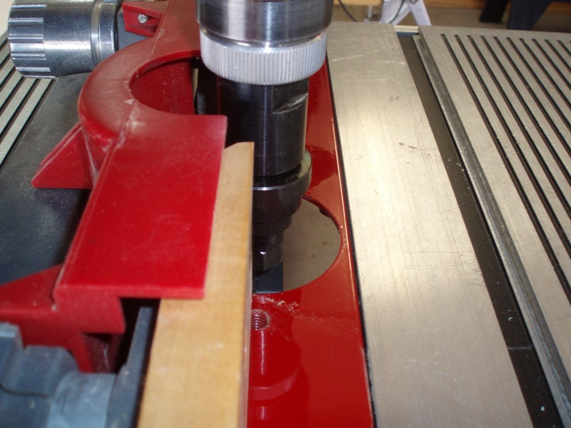

pennview wrote:I agree that lawyers get involved too much in things (just look at all those lawyers in Washington, DC, that represent us) but Shopsmith still sells the Model 500 insert with the larger hole for use in conjunction with either shaper cutters or drum sander.
Dusty, if you have the 510/520 shaper fence, perhaps you could mount it with the two versions of the inserts and see if there is possibly an issue regarding hole location and fence travel. I just have the older Model 500 fence.
I have begun to do what has been requested. More to follow soon - my grandson is on his way to visit.

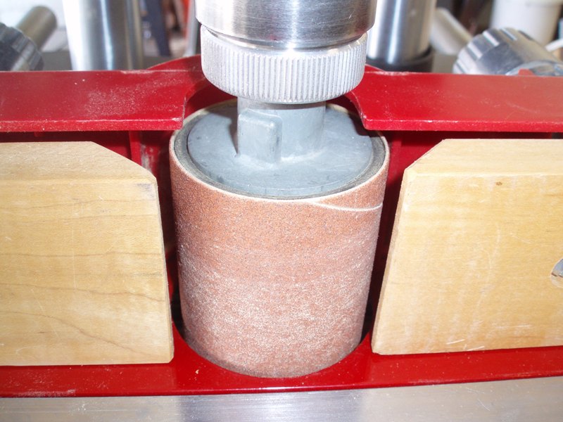

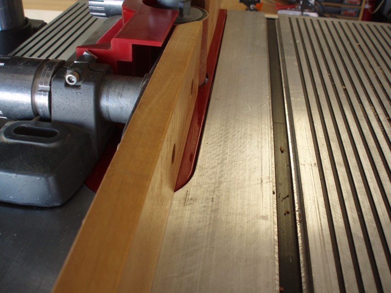

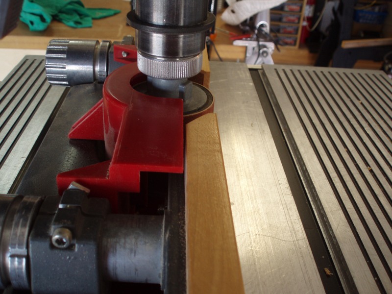

[ATTACH]12662[/ATTACH]
[ATTACH]12663[/ATTACH]
[ATTACH]12664[/ATTACH]
[ATTACH]12665[/ATTACH]
[ATTACH]12666[/ATTACH]
- Shopsmith Mark V in Shaper Configuration 001.jpg (98.83 KiB) Viewed 1937 times
- Shopsmith Mark V in Shaper Configuration 002.jpg (113.46 KiB) Viewed 1937 times
- Shopsmith Mark V in Shaper Configuration 003.jpg (101.19 KiB) Viewed 1933 times
- Shopsmith Mark V in Shaper Configuration 004.jpg (93.18 KiB) Viewed 1933 times
- Shopsmith Mark V in Shaper Configuration 005.jpg (100.07 KiB) Viewed 1933 times
Just guessing, but offering another angle on this. Perhaps if one also gets the under-the-table Speed Increaser, then it "wants" the hole to be a little bit closer to the headstock ? I don't know, though, since I don't have one....heathicus wrote:I was looking for that explanation too. Looking at Dusty's pictures, though, I thought I had an explanation, but as my mind processed it more, I'm still confused.

That guess is as good as mine. I only have a 500, not a 510/520 so I'm just guessing too.nuhobby wrote:Just guessing, but offering another angle on this. Perhaps if one also gets the under-the-table Speed Increaser, then it "wants" the hole to be a little bit closer to the headstock ? I don't know, though, since I don't have one....

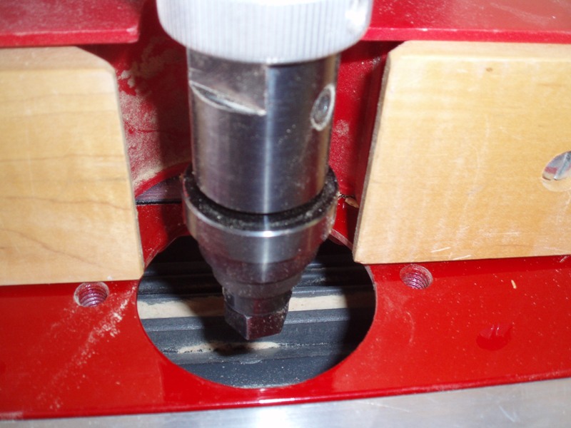

Just a couple more pics.
[ATTACH]12667[/ATTACH]
[ATTACH]12668[/ATTACH]
[ATTACH]12669[/ATTACH]
[ATTACH]12670[/ATTACH]
The fence is adjustable left/right, in/out and width of space between the two sides. Couple this with the table being adjustable in/out and there is a pretty good range.
I have shown pictures but they have not answered any questions that I might have on this.
