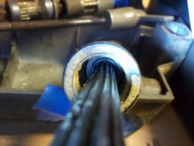

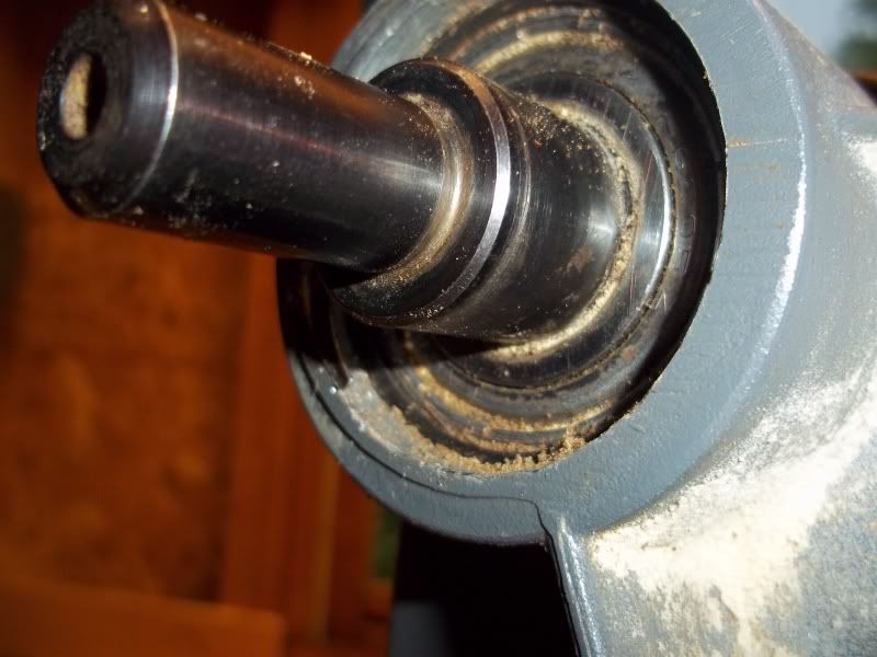

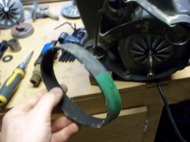

Hit it again tonight for about an hour or so. I started working on the drive sleeve assembly.
Started by removing the retaining ring that holds the drive assembly sleeve in the headstock. I used a flathead screwdriver to pop the ring out. It's hard to see here but it's on the outer edge inside.
Here is a picture of the spring starting to come out.
(more in the next post)
jayp413
Posts: 206
Joined: Sat Apr 30, 2011 11:25 am
Location: Westfield, Ma.

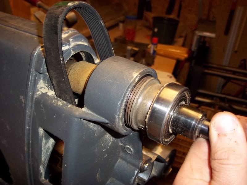

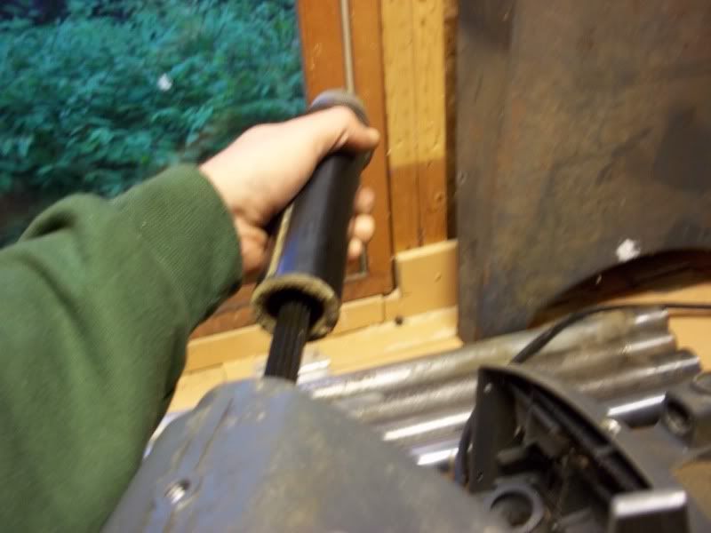

Post by jayp413 »
Once the ring was removed I was able to slide out the drive sleeve.
The belt was in great shape! :cool:
(more in next post)

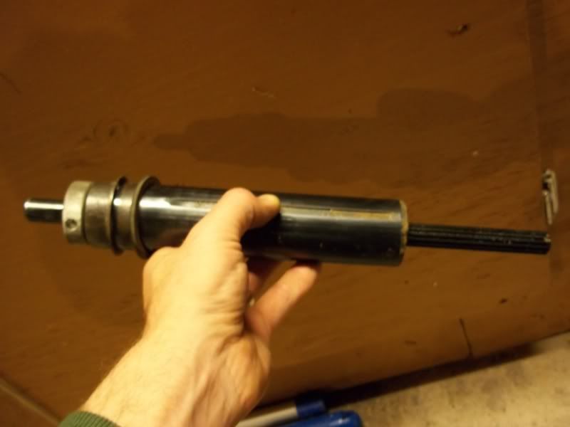

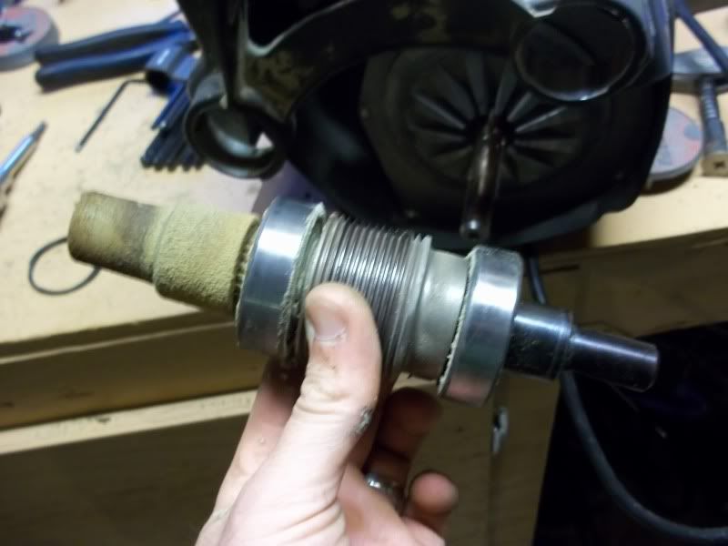

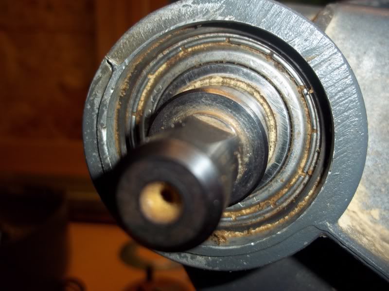

Post by jayp413 »
The quill assembly removal was next. I loosened the allen screw ontop of the headstcok and advanced the quill until I felt it disingage and removed it.
Can anyone tell by the picture if it's a one or two bearing quill/ it looks to be two but i'm not positive.
