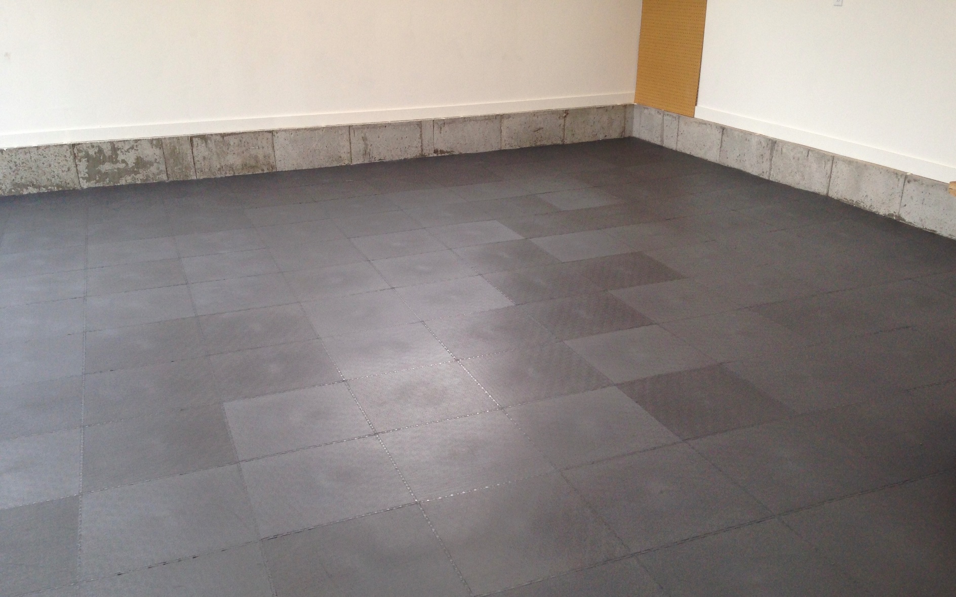

benmcn
Posts: 106
Joined: Sat Dec 27, 2014 6:54 pm
Re: How do you guys do it??
Post by benmcn »
I looked at both epoxy flooring and vinyl tiles for my garage floor. In the end I chose to go with the vinyl tile option.
As has been mentioned, when done “properly”, installation of epoxy flooring can take several days. I wasn’t to thrilled at the thought of leaving all of my tools outside while waiting for the cement to prepped and epoxy to cure. Additionally my garage floor has wide expansion joints with rounded edges that even the three inch castors didn’t like. This lead me to looking at vinyl tiles.
The cost for the tiles was less then the epoxy. Additionally installation could be completed in one day with minimal concrete prep work. The vinyl tiles are “ softer” to stand on all day then concrete and if you accidentally drop something the tile is much more forgiving. The tiles bridge the concrete expansion joints fine and I haven’t had any problems moving things around.
I have had these installed for 5 years now. For the most part I have been happy with their performance. The tiles have picked up some stains but for the most part are holding up well. That being said, a well done epoxy floor looks really nice!
