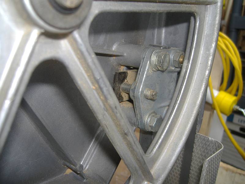

Hi,
I don't see any nylon bolt. Here is a picture of what mine looks like in that area.
[ATTACH]13795[/ATTACH]
So can you give me the low down on that modification. I have no problems drilling and taping as long as I know where it should happen. Pictures work or a simple sketch, photo mark-up????
Tried to look at the exploded parts diagram, I do see the nylon bolt (#65)(517908) but not where it goes.
Thanks for the information, I would like to get this upgrade done too.

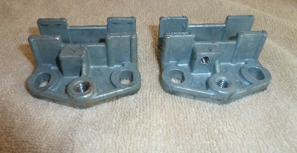

Ed,
I see yours is the old style without the nylon bolt. I checked with SS and they are out of the new brackets so you will have to modify the one you have. I have a couple of saws here in my CO shop that I modified and the one I took a pic of one I used a 1/4x20 bolt about an inch long as I recall. Simple fix and it takes care of the side play. My camera is not working well so hope this helps.
ldh
[ATTACH]13796[/ATTACH]
ldh
- GuideBracket.JPG (91.79 KiB) Viewed 13569 times

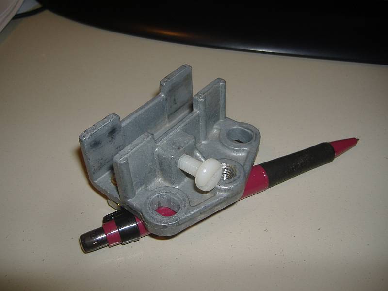

Bob,bobgroh wrote:Hey, I would also like to see a bit more on the modified part. I do have the older version of the bandsaw and I do have some play in guide bar so this sounds like a good mod to make. I took a look at the 'parts explosion' in the manual and I am guess that we are talking about drilling and tapping a hole in #57 on the diagram (SS PN 502549 Guide Column Bracket) for a nylon screw. The screw will then bear up against the Blade Guide Column (#58 on the diagram).
Assuming this is correct?
Picture was a great help by the way.
The bracket on the right has been modified. I have used both 1/4 and 5/16 bolts. The one shown is 1/4x20. An easy fix and well worth the time.
ldh
[ATTACH]13797[/ATTACH]
- GuideBracket2.JPG (69.16 KiB) Viewed 13564 times

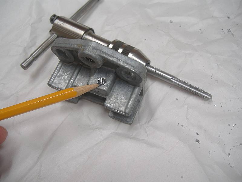

Didn't get as far today as I would have liked. My son is building a deck and they want it finished for a party, Granddaughter turned 1 today but the party is Sunday. So I've been spend some extra hours on that this week, and today we finished about 8:30...
Took the saw apart so I could do the drilling and tapping for the nylon bolt. The drilling/tapping went fine but if I were to do it again I use a slightly larger tap drill then a #7 to make the tapping easier (1/4 - 20).

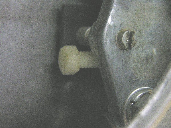

The only nylon bolt I had was 1" long, that happens to be a little to short, yes another hardware store trip in the future. What happens is the head hits on the casting boss, since it is nylon it flexes but a 1/2" longer and it would be back far enough so it would not interfere.
I have a good feeling about this modification, it seems like the right thing to do so I hope to get things back together and test it out.
Here is a couple of pictures, just in case you wanted to see the modification.
[ATTACH]13798[/ATTACH]
[ATTACH]13799[/ATTACH]
