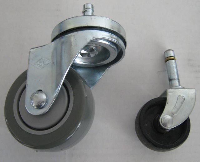

I ended up picking up some casters from my local casters place (only 3 or 4 miles from my house, so thats nice). They were $7.50 each, so $32.85 with tax. My shopsmith ones should arrive early next week, so I will have those for comparison. Here is a photo of the casters from my local place next to the original SS one:
[ATTACH]14386[/ATTACH]
These are 3" Polyurethane/Polyolefin with 'precision bearings'. I am sure if i went with ones without bearings they would be a bit cheaper.
Don't know if I will get to installation before my other ones get here. The baseline assumption would be to move the holes 1/2" higher (ie: the increase in the radius of the wheels.

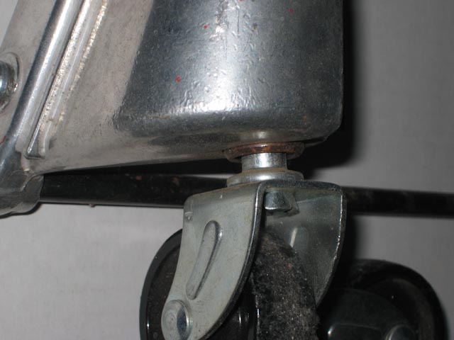

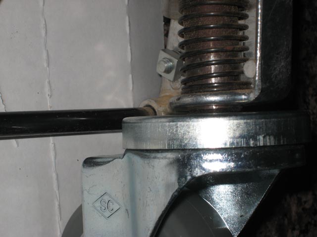

Interestingly enough, on closer inspection there is more to the positioning than just the difference in the wheel size. The original casters are 1 15/16" long, but don't stick in all the way.
[ATTACH]14387[/ATTACH]
[ATTACH]14388[/ATTACH]
[ATTACH]14389[/ATTACH]
My replacements are 1 3/8" for the stem...so 9/16" shorter. I went back and inspected the photos on the shopsmith page, and it appears that theirs are probably 1 3/8" as well. I think the ones I found are identical except for the color (simply an issue of what was in stock).
So, what does this mean? Well, it means that we need to compensate. Measuring from the edge of the socket where the wheels attach, it looks like the old wheels have their axis 1 5/8" down, whereas the new wheels are 2 1/2" lower.

damagi wrote:Interestingly enough, on closer inspection there is more to the positioning than just the difference in the wheel size. The original casters are 1 15/16" long, but don't stick in all the way.
If your new casters have a 1 3/8" stem they will go all the way in and the base of the stem will rest against the bottom of the piston. As you mentioned the SS originals bottom out in the piston bore. That introduces a negative height gain.
All that is left is the difference in the floor to the stem base dimensions.
To double check the math on this before drilling any new holes, why not measure the height of the legs above the floor with the original casters at the two "up" positions, and then install the new casters and take similar measurements. Then you can calculate where to drill the holes to remount the brackets based on how much lift you want. Just ensure that there is ample room for the casters to be raised above the bottom of the legs when the legs are in the down position.
