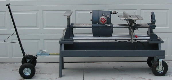

Portable Shopsmith
When I started adding a 1000 sq ft addition to our home, it would rain every day. When needed, it forced a long walk to the shop to use my Shopsmith and various SPTs. I was offered a 500 that fell off the back of a pickup truck for $100 which I brought. Most of the leg, base and headrest bolt holes were broken or torn open. The headstock only lost a little paint. I quickly (one day) made a wooden platform with 8" wheels and added a bar so I could tow this Shopsmith platform with my Kobota tractor to and from to its storage shed whenever the rain would start or stop. The base and headrest was bolted to the platform using longer bench tube studs. I quickly added a 2KW generator (on an extension table) to power the headstock (no power problem starting at FAST) and my portable power tools. All my tools were stored on each side of the platform when moving. I was able to add whatever SPT I needed each day before leaving the shed. Even with the bandsaw attached, there was never a problem with stability when towing or using the Shopsmith. Also, the drill press position was very stable which surprised me. Once the addition was dryed in, I parked the platform inside and moved it with the hand dolly shown in the picture.
Both way tubes had been bent but I had no problem moving the headstock. The way tubes were replaced later. This unit was loaned to a few friends as it was easy to load on my tilt trailer. I still have the platform available if anyone is interested.
[ATTACH]14705[/ATTACH]

I am going to disassemble the construction Shopsmith very soon as I need the room. If anyone is interested, I can make a really good deal on it. No headstock mounted at this time.billmayo wrote:When I started adding a 1000 sq ft addition to our home, it would rain every day. When needed, it forced a long walk to the shop to use my Shopsmith and various SPTs. I was offered a 500 that fell off the back of a pickup truck for $100 which I brought. Most of the leg, base and headrest bolt holes were broken or torn open. The headstock only lost a little paint. I quickly (one day) made a wooden platform with 8" wheels and added a bar so I could tow this Shopsmith platform with my Kobota tractor to and from to its storage shed whenever the rain would start or stop. The base and headrest was bolted to the platform using longer bench tube studs. I quickly added a 2KW generator (on an extension table) to power the headstock (no power problem starting at FAST) and my portable power tools. All my tools were stored on each side of the platform when moving. I was able to add whatever SPT I needed each day before leaving the shed. Even with the bandsaw attached, there was never a problem with stability when towing or using the Shopsmith. Also, the drill press position was very stable which surprised me. Once the addition was dryed in, I parked the platform inside and moved it with the hand dolly shown in the picture.
