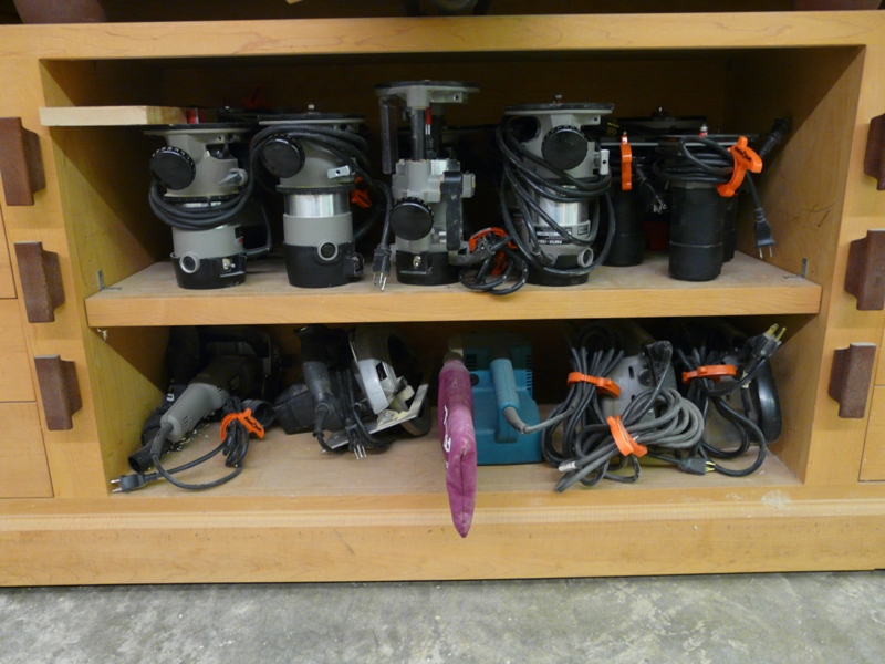

mrhart wrote:11 routers seems like alot for 2 hands...
But I want to make my first router purchase and based on your "floor" stock
, what do you reccommend for a 1-2 router garage sir? With your background I would value your opinion.
The bosch one with the pretty wood handles at Lowes looks good, but I'm not router -versed.
Well maybe I am old school but I always reach for a PC 690 when I need a router and I have used a lot of others. The PCV 890 series and the Bosch routers always seem top heavy to me. If I could only have two routers in my shop one would be a 690 with an additional plunge base. http://www.amazon.com/dp/B00006411C/ref ... B00006411C and the other would be this PC trim router. http://www.amazon.com/Porter-Cable-Comp ... 347&sr=1-7. If you ever need one for a router table. http://www.amazon.com/Porter-Cable-7519 ... 548&sr=1-1

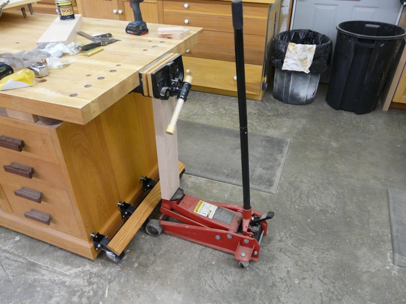

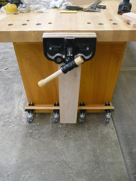

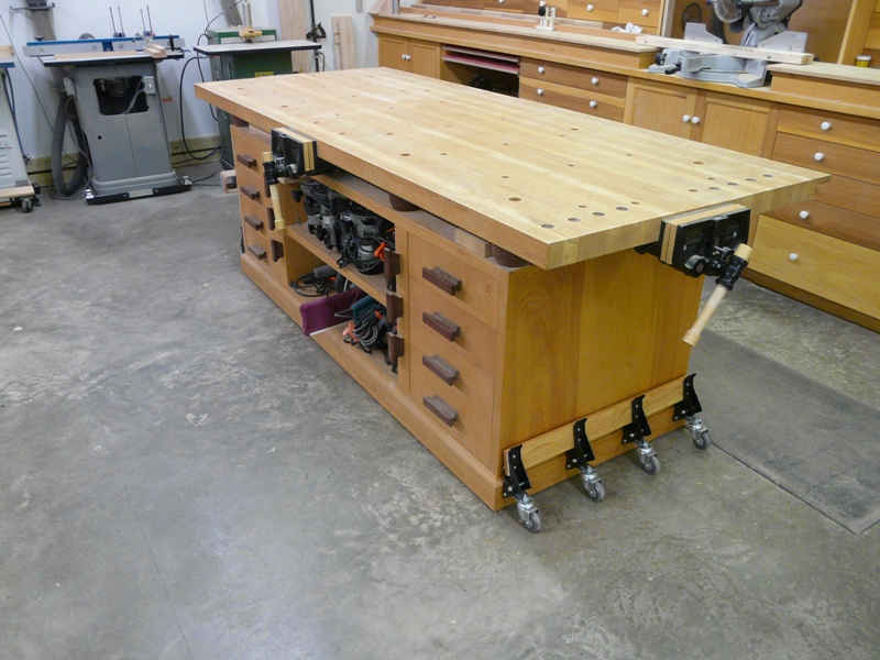

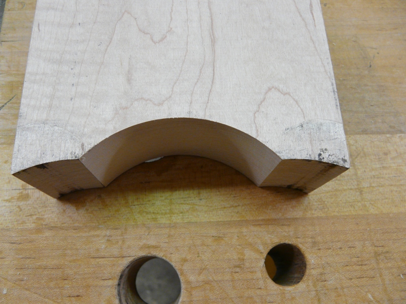

Plus 1 on the hydraulic jack. I dont believe the bench weighs any more than my truck.
[ATTACH]14961[/ATTACH]
I cut this to clamp in the end vices and press against the solid guide rods and not the adjustment screws.
[ATTACH]14962[/ATTACH]
Sets quickly and clamps on the bottom side of the vices.
[ATTACH]14963[/ATTACH]
It only needs to raise about 1 inch and the cam levers are easily set by hand.

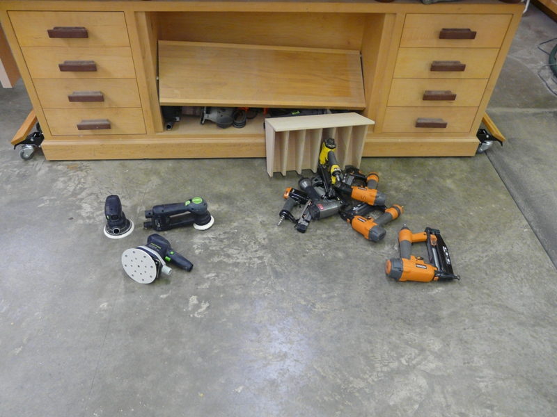

Grandmother always said Pride comes before the fall

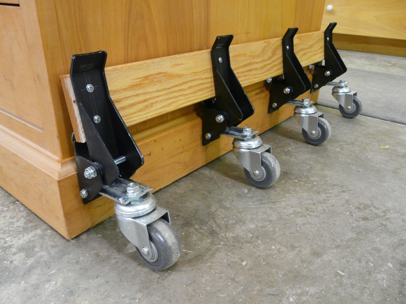

Well the casters work great and I can easily roll and spin the heavy beast. I was feeling proud of my success when another crash occurred.

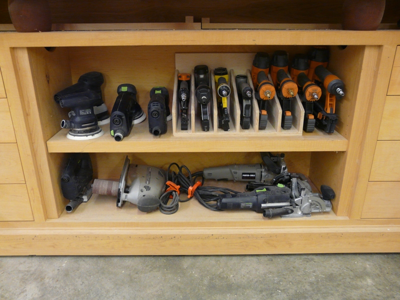

[ATTACH]14964[/ATTACH]
Should have checked that other shelf.
[ATTACH]14965[/ATTACH]
This project became a shop improvement in a shop improvement. I replaced the shelves and added some L brackets for additional support.
[ATTACH]14966[/ATTACH]
I had a couple of spare bases on hand so I will take Farmers advice but will buy one of those Nascar style light weight jacks instead of new routers.
[ATTACH]14967[/ATTACH]
The bench is back in place and all the stars in the Universe realigned so I can get back to work.
[ATTACH]14968[/ATTACH]
One thing that I did notice is that the caster wheels do not stay suppended in mid air when retracted as in the picture. It would have made sweeping a lot eaiser. Over all I am not at all disapointed in these casters. They roll great and seem to be of good quality. Heck they would probably even work properly on an bench that weighs less that a full grown Cow!
