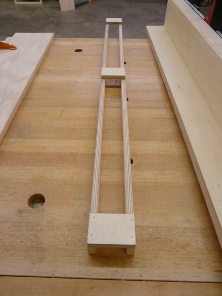

In the last picture this post, what is the piece that appears to be 3or4 length of 1/2" plywood held together by cross braces. Is this just a fence to clamp too.

BigSky wrote:In the last picture this post, what is the piece that appears to be 3or4 length of 1/2" plywood held together by cross braces. Is this just a fence to clamp too.
[ATTACH]15125[/ATTACH]
I believe that you are referring to the sacrificial fence that I designed. It will need replacing often because of glue build up so I designed it double sided so that I can just flip it around a use both sides.

mbcabinetmaker wrote: It will need replacing often because of glue build up so I designed it double sided so that I can just flip it around a use both sides.
Couldn't ya just wax or shellac it to keep the glue buildup down?

beeg wrote:Couldn't ya just wax or shellac it to keep the glue buildup down?
Yes I do have wax on it but when you go through as many doors as I do eventually the glue still builds up.

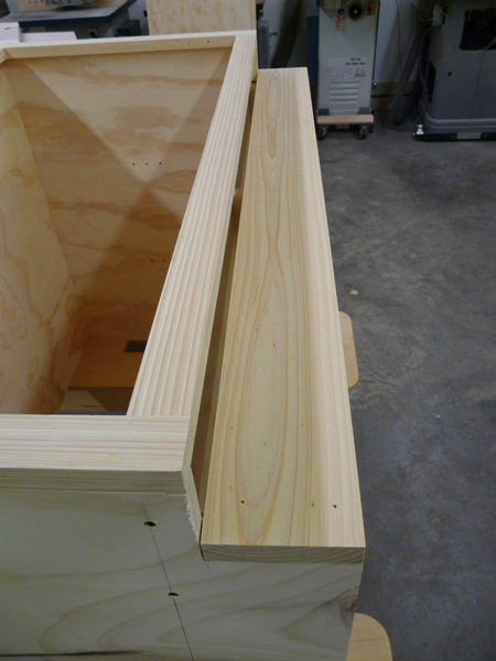

The rest of this job is pretty straight forward. Just cutting and assembling the plywood parts and hanging the doors.
[ATTACH]15151[/ATTACH]
Cabinet sides attached to the face frame.

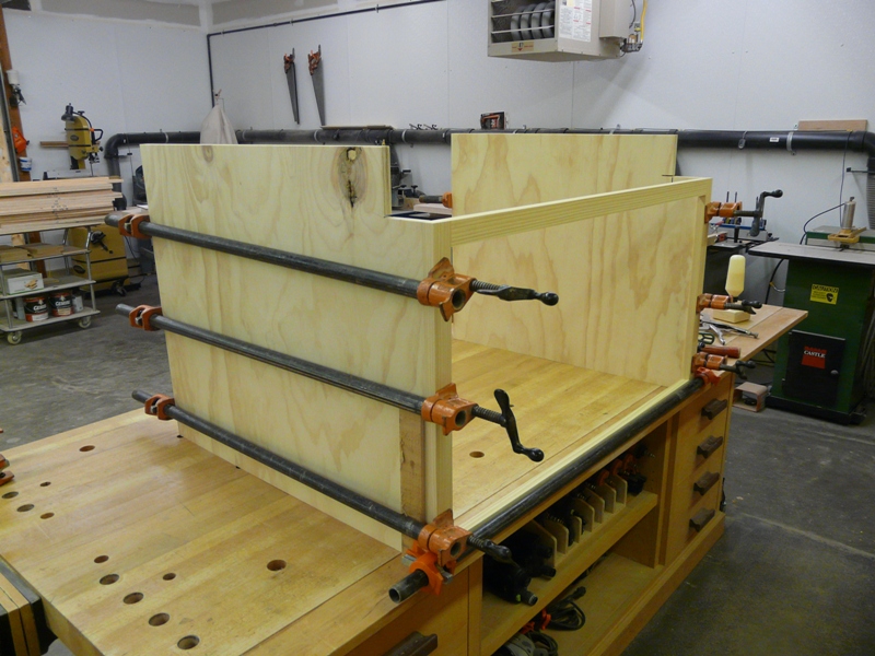

[ATTACH]15152[/ATTACH]
Toe kick added.

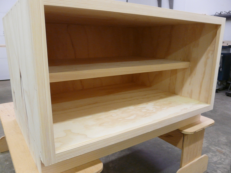

[ATTACH]15153[/ATTACH]
The shelf sets on adjustable pins.

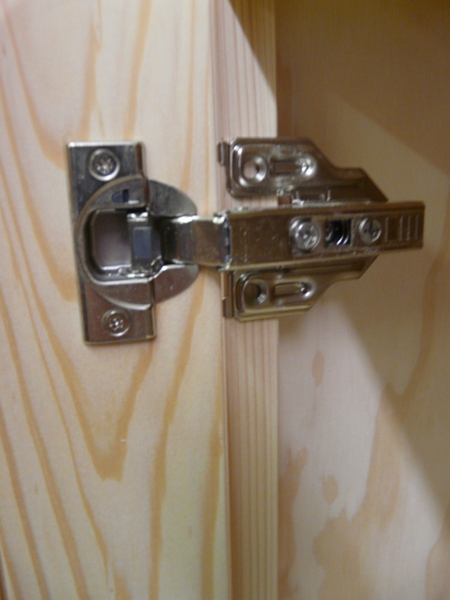

[ATTACH]15154[/ATTACH]
Attaching the door hinges to the face frame.

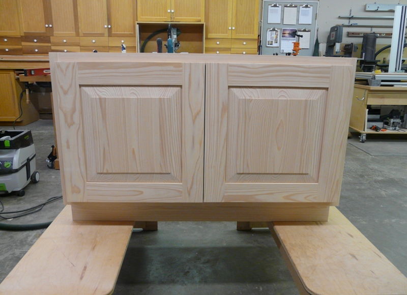

[ATTACH]15155[/ATTACH]
Cabinet completed.
