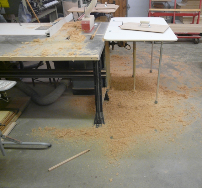

Now that is a mess even Dusty will be proud of!;) No eating off the floors until that is cleaned up.

Perhaps that is why so many real men suffer from lung issues.garys wrote:Dust collectors are for sissies. Real men have a pile of sawdust on the floor to show that they actually did some work.

When they live long enough!;) Goes for 'Camel' smokers also!:eek:fjimp wrote:Perhaps that is why so many real men suffer from lung issues.

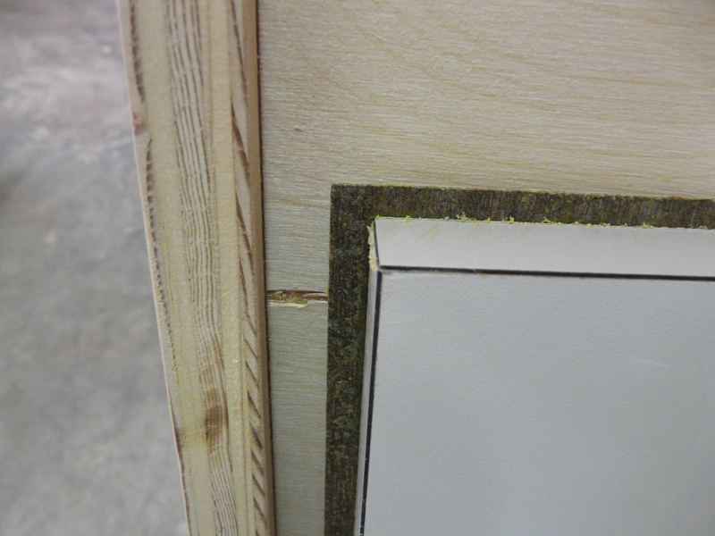

Finished the dog bone doors this morning.

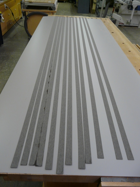

Ripping 1 inch strips of Formica. Well actually Wilsonart!
[attach]15489[/attach]
[attach]15490[/attach]
Cutting to length.

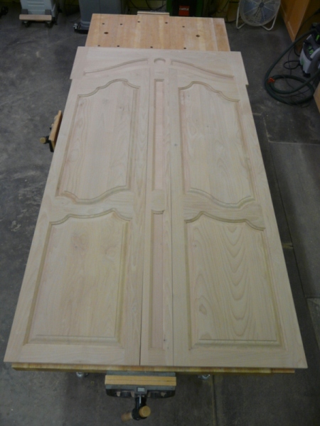

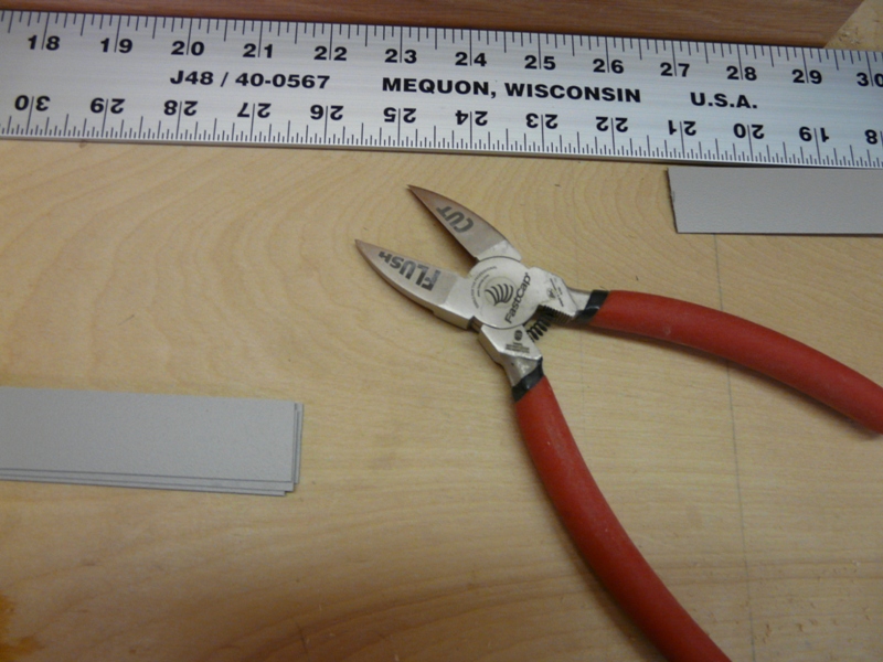

Cutting to length.

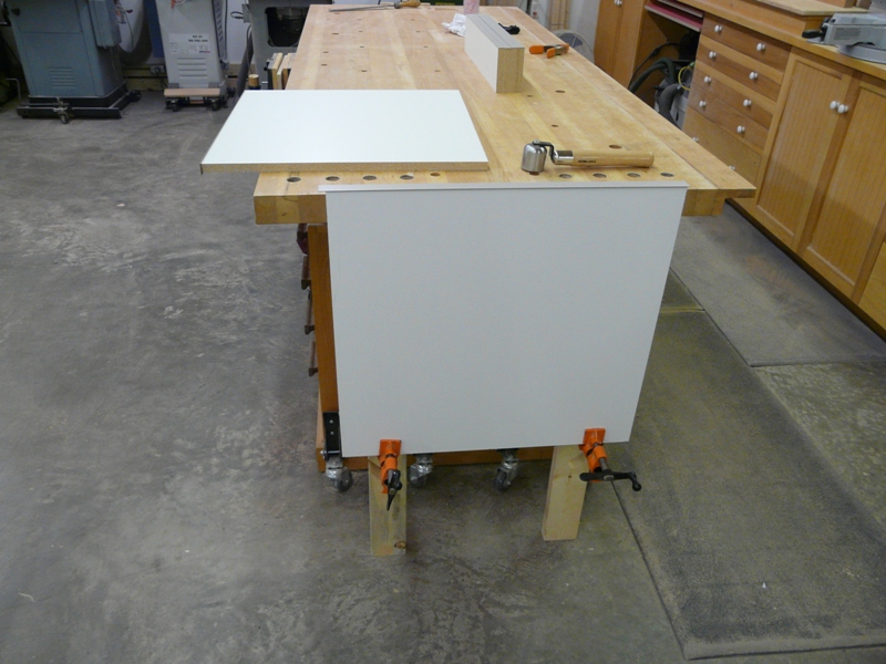

I have cut a piece of scrap to serve two purposes. It will shield the cabinet ends and also serve as a place to spray the banding. I am using a clear spray grade glue. It has a little yellow color to it however.
[attach]15494[/attach]
The new low down bench vice is working like a charm.

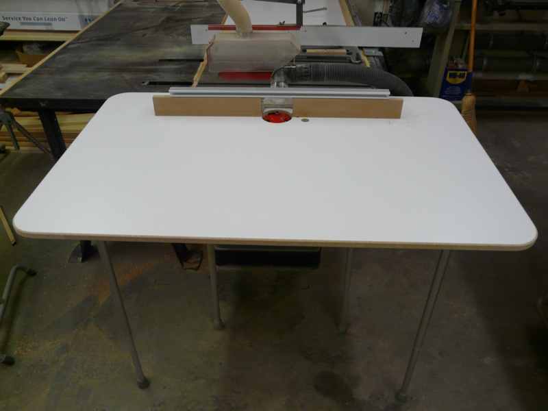

[attach]15495[/attach]

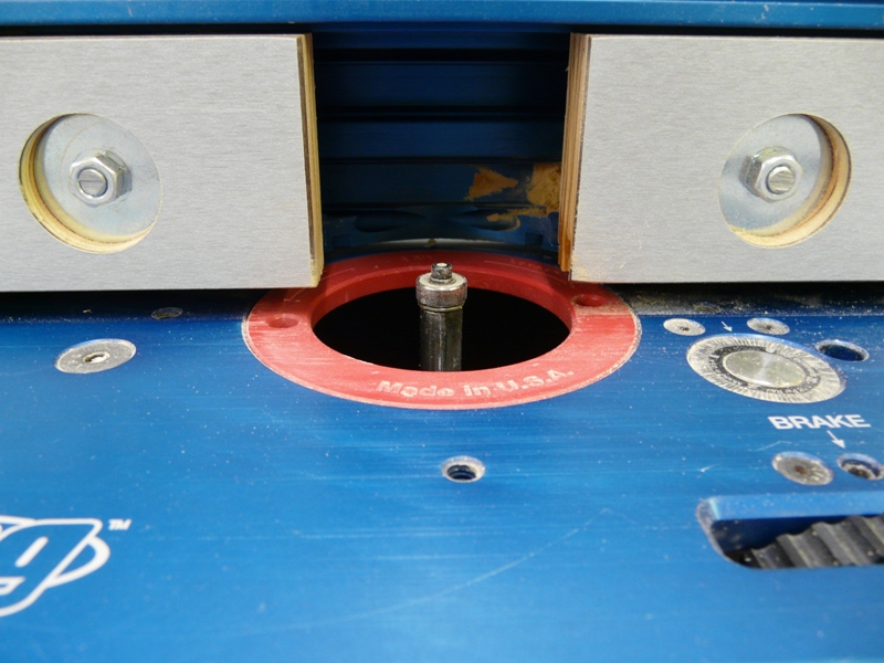

I have set up the router table with a straight bit with a bearing for trimming. For this operation I like to use a bit that has been sharpened several times. That way the bearing is a little proud of the cutter so there wont be any nicking of the melamine. Notice that the fence is adjusted to allow the banding to slide under.

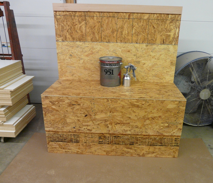

Ah! The mystery OSB box. Actually it is a fixture for spraying contact cement without getting it all over the shop.

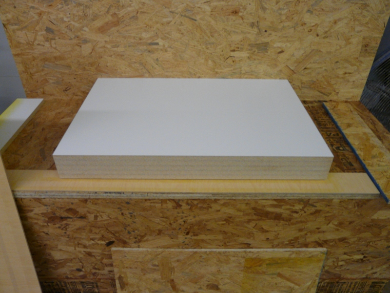

A stack of cabinet ends that need to be edge banded with Wilsonart.

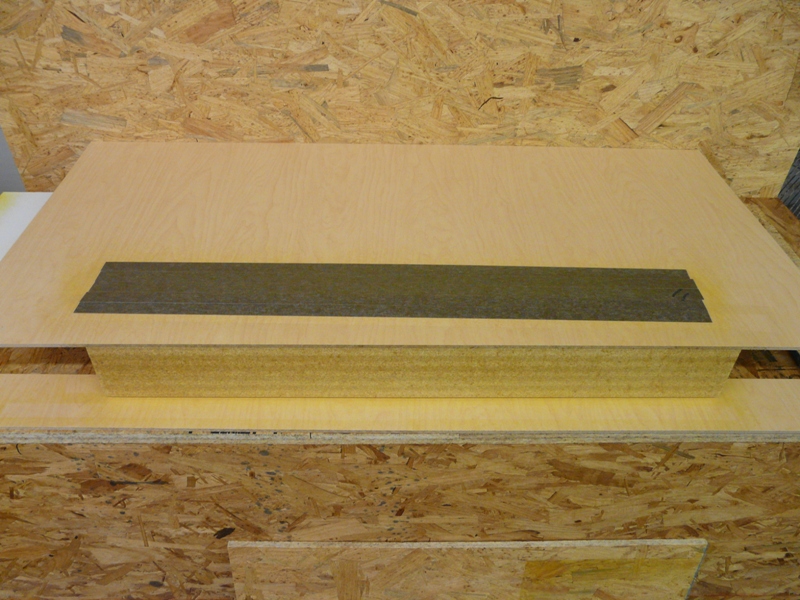

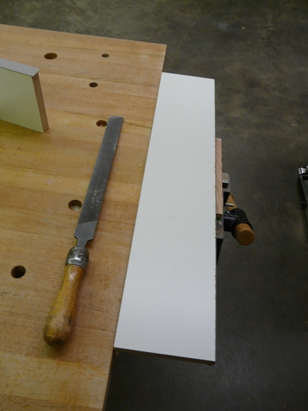

After the routing all the banding has to be hand filed. Hand filing is a lot like hand planing. It takes a lot of practice and in the beginning you will make some gouges.

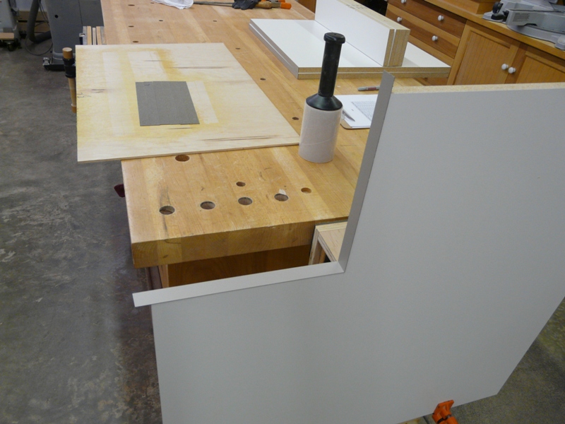

This is the bottom of a corner base cabinet. It requires some other techniques. First the banding has to be squared up. Guess what machine I called on.

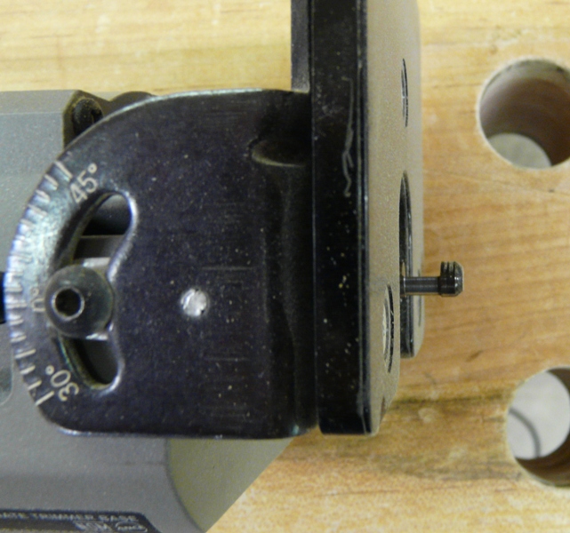

This banding will have to be trimmed by hand using a small router and then finishing up by filing into the corners.
[ATTACH]15514[/ATTACH]

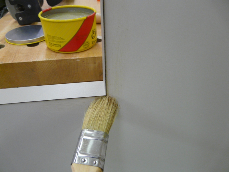

First you need to use some wax on the melamine to keep the solid bit from doing damage. Johnson paste wax. Good stuff!;)

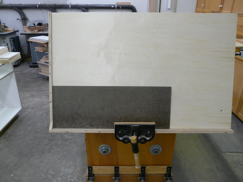

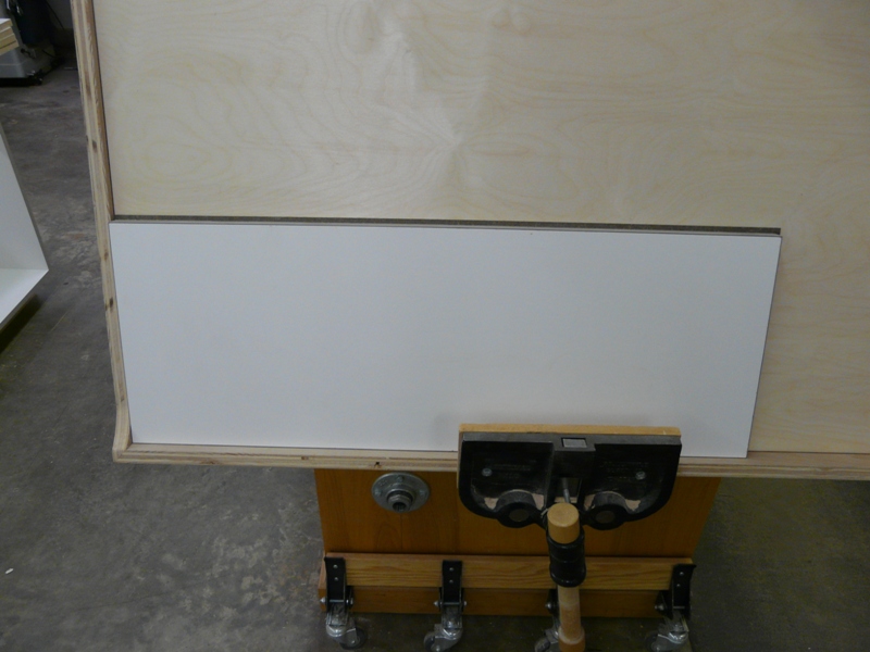

This is a jig that I designed and built to make it easier to apply Wilsonart laminate to the doors and end panels. It leans at about 10%.
[ATTACH]15619[/ATTACH]
I have a simple saw kerf 1/4" deep along the end and bottom. I just slide the laminate into the groove and lay the door on top.
You may have noticed that I made a small improvement to the jig to make it easier to push the panel out.
[ATTACH]15620[/ATTACH]
[ATTACH]15621[/ATTACH]
[ATTACH]15622[/ATTACH]
What I have in the end is perfectly aligned laminate with 1/4" overhang for trimming.
