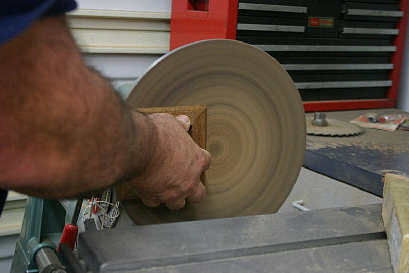

For the record, I realized I left out some pics of a process step to sand and smooth the exterior surfaces after the the sides were assembled. The tops were also treated the same way after they were assembled.
I sanded the surfaces freehand on the disk sander with 120 grit paper. This removed the various 'issues' going on the surfaces (i.e. tiny lap joint steps, saw marks, miters on the top not exactly flush with it's neighbor etc.). Prior to sanding, I would take a pencil and mark the surface in several places so that I could watch how the sanding process progressed.
The critical sanding part was making sure that the initial part contact was flush with the sanding disk before applying any pressure. Once the part contacted the disk, kept even pressure on the part. I would rotate the part front to back a couple times to make sure it sanded evenly since the center of the disk has less SFPM than the outer surface.
[ATTACH]8906[/ATTACH]
[ATTACH]8909[/ATTACH]
[ATTACH]8908[/ATTACH]
I was almost going to use the conical sanding disk to do this op so that I could use the fence vs. holding freehand but.....I took a chance and it came out good. No divots or signs of misalignment during initial contact with the disk.
I finished off the sanding with a finishing sander with first 150 then 220 grit paper.
