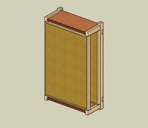

Next project - Pegboard Storage Rack
Decided that this is going to be my next project. It's a pegboard storage rack. Liked this one due to the simplicity, need, and that fact that I already have the material.
[ATTACH]9089[/ATTACH]

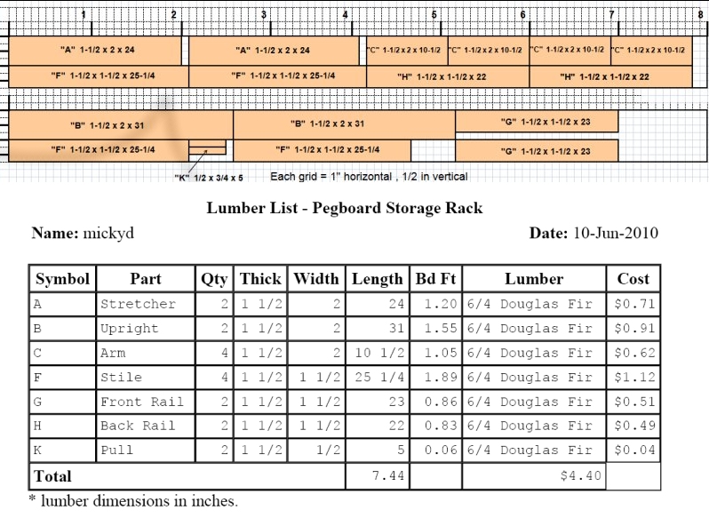

With all that 'extra time' this past long Memorial Day weekend, I recreated this design in sketchup from a 1996 ShopNotes magazine. The original plan calls for a 2' x 4' for the wall mount unit but I am going to instead mount it on the side of my workbench so I need to bring the size down to about 24" x 31".
Nice feature is the two swinging doors each with 2 mounting surfaces. I'll be able to add a 5th fixed surface in back of it facing the inside of the workbench.
Used my trusty board foot calculator website. Comes out to about 7.5 B.F. I'll use Douglas Fir 2 x 4's
Instead of diving in and starting to cut without a full plan, like I did with the candle lanterns, I also did a cutting layout. It will take just two 2" x 4" x 8'.

mickyd wrote:Decided that this is going to be my next project. Liked this one due to the simplicity, need, and that fact that I already have the material.![]()
[ATTACH]9056[/ATTACH]
With all that 'extra time' this past long Memorial Day weekend, I recreated this design in sketchup from a 1996 ShopNotes magazine. The original plan calls for a 2' x 4' unit but I am going to instead mount it on the side of my workbench so I need to bring the size down to about 20" x 24".
Used my trusty board foot calculator website. Comes out to about 8.5 B.F. I'll use Douglas Fir 2 x 4's
Instead of diving in and starting to cut without a full plan, like I did with the candle lanterns, I also did a cutting layout. It will take just two 2" x 4" x 8"'s.

Ya gonna rip them with a laser??? I do not see kerf waste. If yer thinking bandsaw, go slow and watch(closely) for blade 'drift'.
BTW yer gonna buy 2-2x4-8' at 5 1/3 bf each = 10 2/3 bf @ 0.56 = $5.97 You may/should consider a more gooder grade of 2x4!

Gonna use the table saw and split the difference on the kerf, taking away 1/16 off each of the widths of the mating parts. My 2" wide pieces will be 1-15/16" and the 1-1/2" wide pieces will be 1-7/16". Driving my 50 mph, no one will ever know!!!!JPG40504 wrote:Ya gonna rip them with a laser??? I do not see kerf waste. If yer thinking bandsaw, go slow and watch(closely) for blade 'drift'.
Couldn't you tell I was using a table saw based on the layout?? Notice the strategically placed cross cuts so that I don't have to rip too long a piece. Don't feel comfortable doing that yet.
More gooder grade???? That price is for the kiln dried stuff that I thought WAS the gooder stuff'.....$2.98 per 2" x 4" x 8'.

mickyd wrote:...More gooder grade???? That price is for the kiln dried stuff that I thought WAS the gooder stuff'.....$2.98 per 2" x 4" x 8'.
2"X4"X8' at $2.98- - is equivalent to a little more than $1,710/MBF That sounds pretty high alright, but it is an imported hardwood. Still the price of wood for remains competitive to alternatives, for fine woodworking. Also wood is not usually the price breaker to making a hobby project. In making furniture pieces, one can buy a lesser grade and using only the parts of a board that are desired. In other words, we can increase the grade of our shop lumber by accepting the loss of some volume. "Buy big and saw smart."
About grade - In the above post ("book") I didn't even touch on grade -- In brief - grade starts by grading standing timber (trees) - then goes on to log grading - and of course, what we are all familiar with, lumber grading. All three grading systems are confusing but necessary to correctly price this changeable commodity during the lengthy production process. There are books and periodic publications dealing with current grades and prices of lumber by species. "Random Lengths" is one weekly publication about Western softwoods dealing with such information. http://www.randomlengths.com/base.asp?s1=daily_woodwire&s2=market_news&s3=random_lengths
eg]guess[/U] that select grade would bring in about $1,000 or more.
I know this is more info than we need. I'm thinking hardwood data would be more variable.
